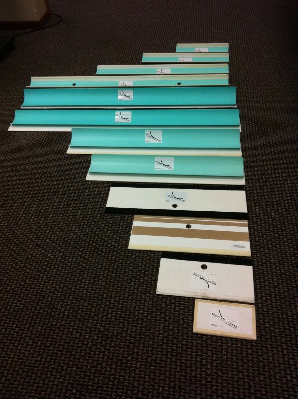

I just counted mine...I have 11 of them. All different tools for different tasks. I mount prints all day long everyday and it's the most used tool in my shop. I don't hardly cut ANYTHING anymore, it's all just mounted w/ the big squeegee. Never hardly buy transfer tape anymore, or waste as much time weeding.
Sorry, I lied...there are 12.
