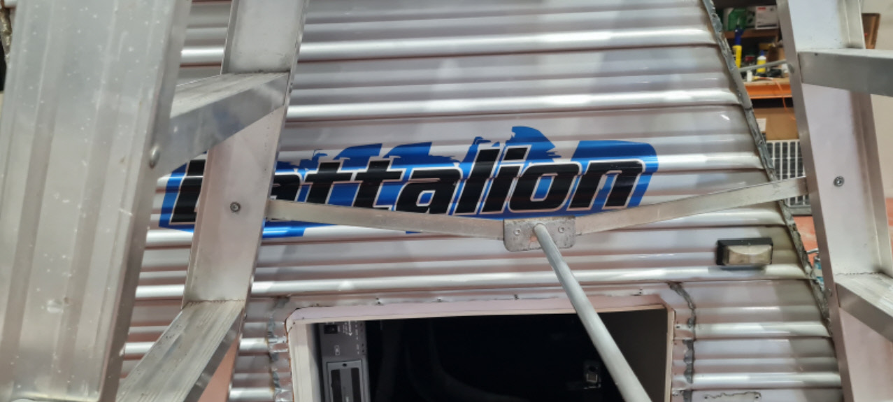

if you're pre assembling, use air release vinyl, it works very well. While this battalion decal is not layered as such, the principle is the same. Pre align on the workbench to make installation easier. I use 3M 1080mc for doing Caravans like this, or for everyday stuff, whatever calendared air release i can get.

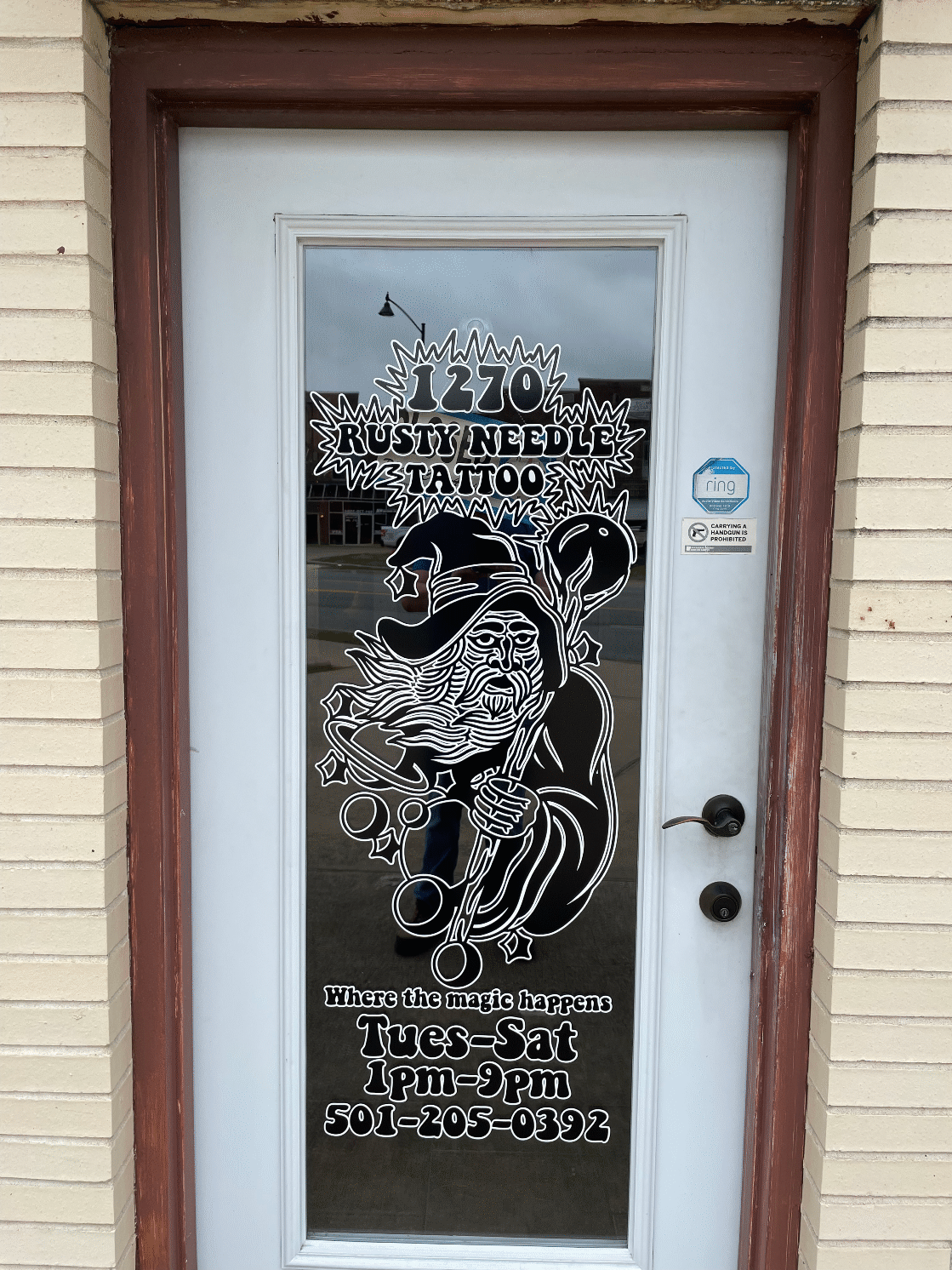

My liner got pretty wet & wrinkled, had to do it wet due to tight registration. Hope it doesn't create issues during installation.
3m makes a vinyl with synthetic liner (clear plastic), helps with wet installations. I did a big piece, nearly 2'x4', and pre registered it in the shop before going out for install since it's so hard to see black on a window. Turned out pretty sick... thought I still have nightmares of chasing down the next weed line on this dudes beard:

I did the layering at the install site using registration marks for both colors.
^^The above looks awesome! Great job. I would've just printed that, not layered two colors of cut vinyl.
That's insane, my boss would not sign up for this... But I'd want to try. Well done. I'm impressed.

Burton, that 3M clear back stuff blows. Make 4 squares, cut them on each color, weed/tape, cut right against the corner of the boxes then align the squares as you layer.
I thought about that, but to get it visible from both sides, I'd need to print a reverse image and install it inside, which wouldn't be nearly as cool.
This was done as a trade for a tattoo for my wife, took me something like 2 hours, took him about 1 hour.
It's what I grew up weeding, to the point that I hate anything on paper liner. It does have it's drawbacks, like cutting too deep into the backer causes nothing to lift with the masking, but at least it doesn't carry half a layer of masking with the adhesive.
