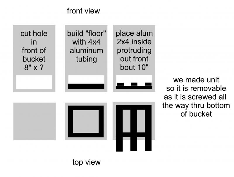

aight, don't laugh at art but this is what we did. Our bucket is one man and has a thick plastic liner inside. We built this because we had to install 4 200# gemini plaques on base for another company, and Im not getting any younger

Please for the love of god do not cut a hole in your fiberglass bucket like that. post a pic of your bucket and ill give you some tips if you really need this.

Bucket manufacturer, osha, smart insurance guys, and the like would probably frown on it but we did about the same as BobM mentioned. I can get a pic tomorrow.
The bucket mounted supports can make your bucket a little tipsy if you overdo the load (in our experience anyway) so be more careful there.
The mast-mount also works but has it's limitations too. When servicing a face thats at the height reach limit of the bucket, it can be difficult to maneuver or keep the panel from getting scratched by the bucket (also in our experience).
Our installers favorite is the cage style bucket on our big truck. he just lets a boot stick over the edge of the toe boards, set the sign face on the top of his foot, and away you go. This doesnt work well for smaller height faces but I have seen him effortlessly lift 4' and 5' high faces lots of times.
Open bucket and boot here too
