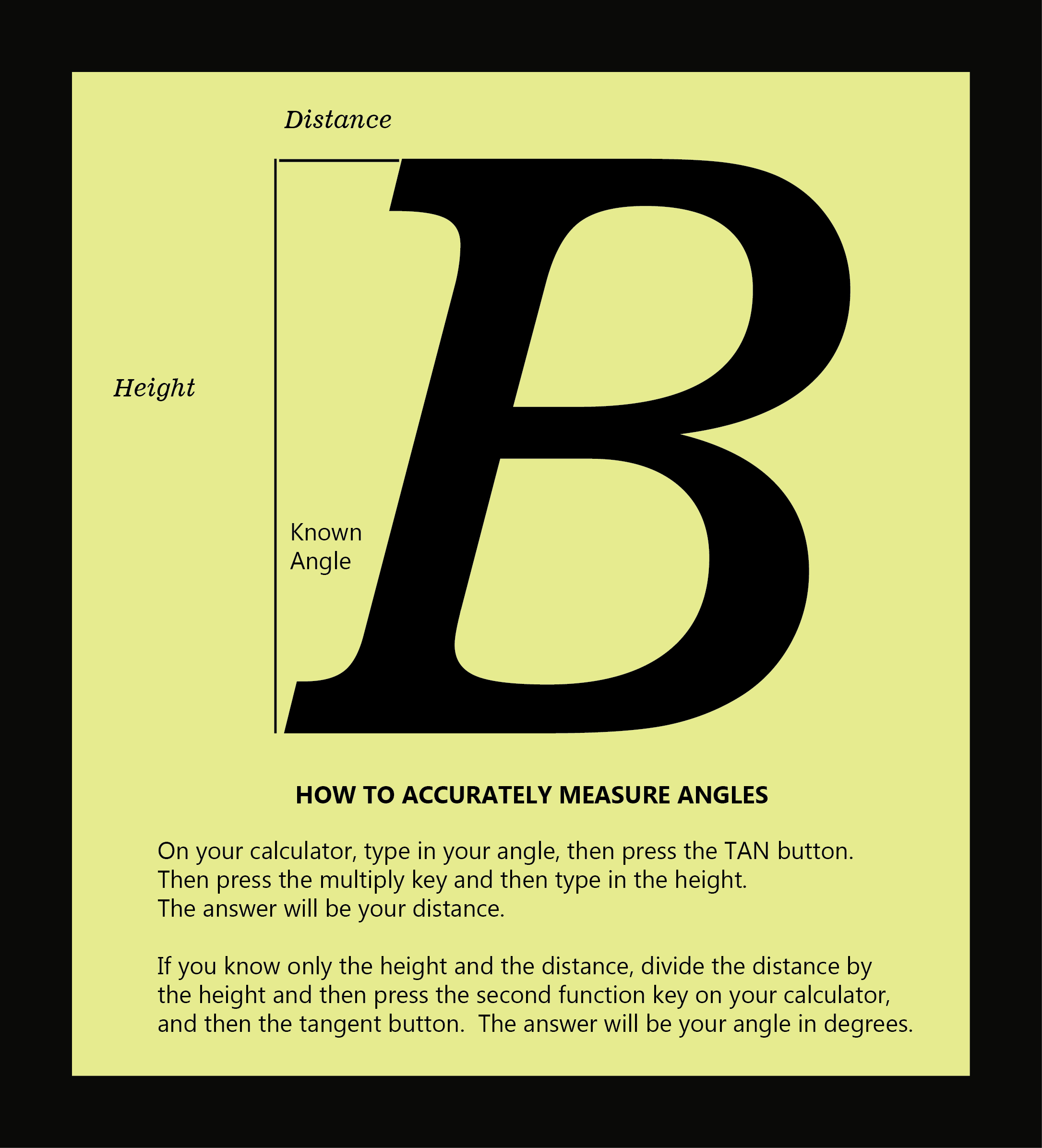

I'm one of the resident tool and die makers. Save your money. I believe a universal bevel protractor is overkill, especially since the blade of the protractor will not be as long as your entire project.
A one-degree error in the span of one inch equals .017". Compound that out across 36 inches and you pick up a total error of .612"...which is just shy of 5/8".
If it were me, I'd use trigonometry (specifically, the tangent function), a high quality framing square and a steel engineer's scale (precision ruler). With a few quick calculations, you will have a far more accurate measurement over long distances. I guarantee it. Essentially, you will be measuring the "amount of variance" across a given distance (otherwise known as "delta"). See my example below.
If your measurements were correct to within 1/32" across a 36" span, you'd be accurate to within nearly 3 minutes (1/20 of a degree). Again, the bevel protractor won't be able to reach out that far. For welding/fab work, you should easily be able to get within 1/16", which would put you within 1/10 of a degree across long spans.
And when it comes to designing, only a CAD program will give you angular measurements accurate within minutes and seconds (and if you're using decimal degrees, that would be four to six decimal places out) . BUT, by using trig and a scale, a CAD program is not necessary, so long as you hold your linear measurements to within three decimal places.
Hint: With the exception of the square and scale, that's how surveyors do it. And if they can be accurate to within a fraction of an inch across miles, you know it can't be all that bad. Also, the Egyptians did a pretty darn good job squaring up the pyramids using the same methods.
If you're ever in my neck of the woods (southern lower Michigan), stop by some time. I'll also share some other cool machinist measuring techniques helpful for layout and design.
JB

Good news...the trig problem is really nothing more than a plane geometry problem (solving for an unknown side or angle), so you should be good. Don't let the word "trig" fool you.
But yeah...I get you....trig proofs, axioms, postulates, theorems, etc... could get a bit complicated.
JB
it was funny, trig was the first thing i really had to work at
netsol
