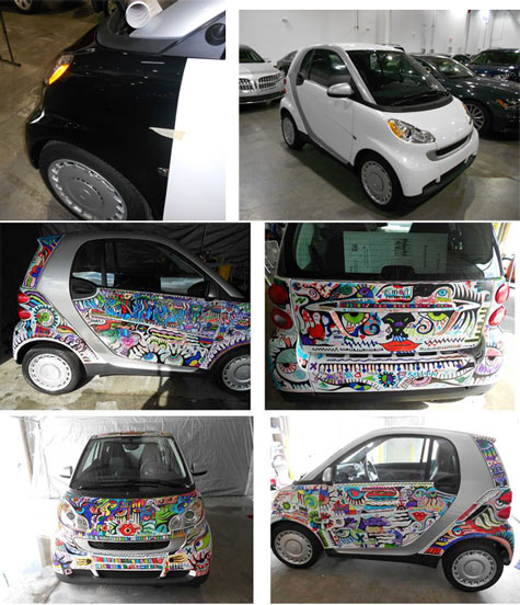

Of coarse I am a little bias but i just loves that frog juice!!!!!!! Seriously last year we wrapped a black smart car in vinyl with no lam and sent it down to Art Basil in Miami and an artist went to town on it, when they got done we used frog juice (mm mmm good) sorry.. to cover the car and it's still out there without any problems from the juice. Next month we will be doing a Prototype Porsche for the same outfit.
