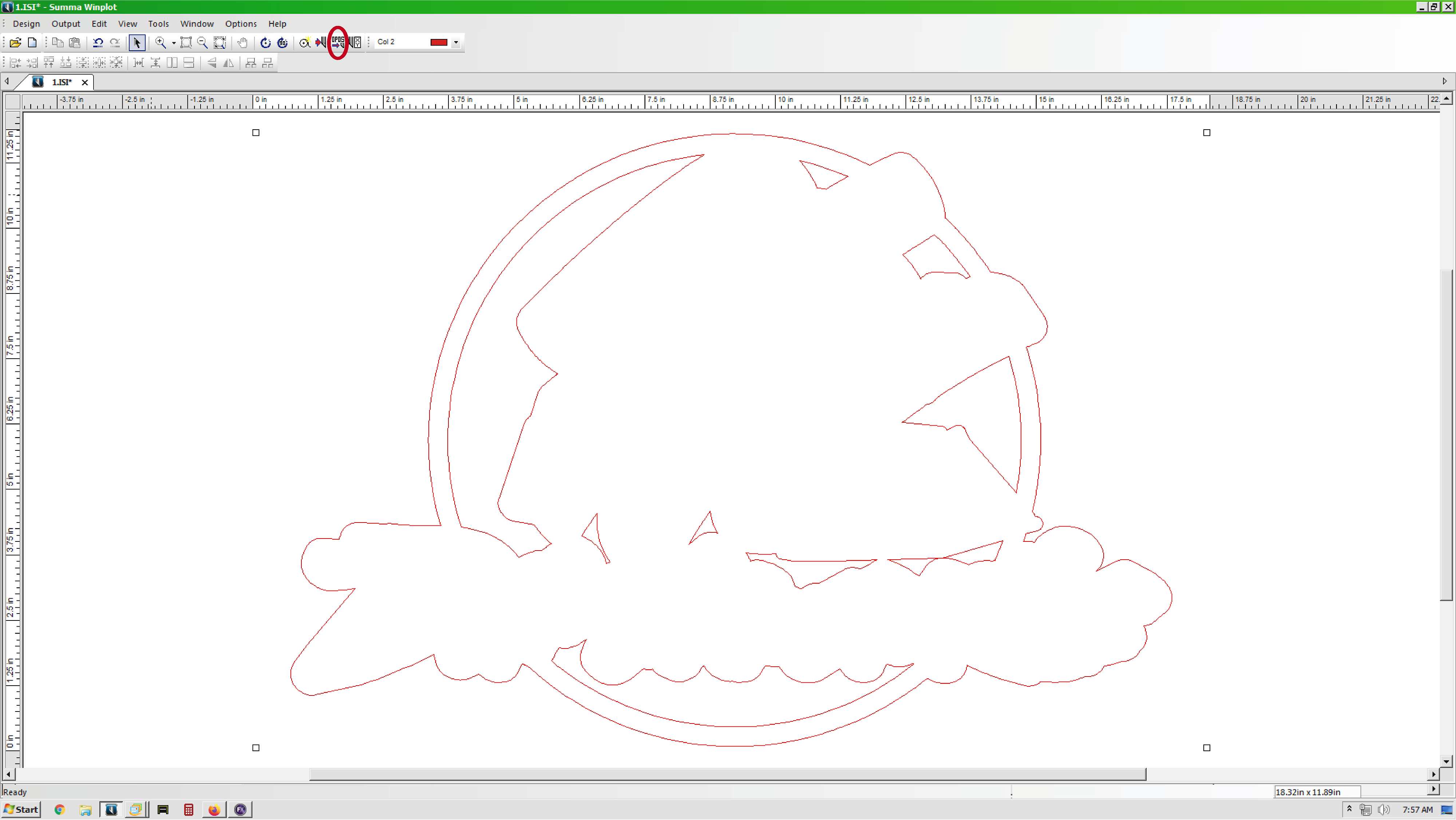

If one were to print (4) .119 inch squares spaced from the 4 corners of your print. This in my case is accomplished in Flexi Sign with step and repeat . Then create a contour cut file including the 4 corner squares.
In my case I use a Summa Cutter with the opos eye system. Then I use a cutting program called Summa Winplot, which is free from the Airmark site. It can automatically find the corner squares as it's registration marks.
