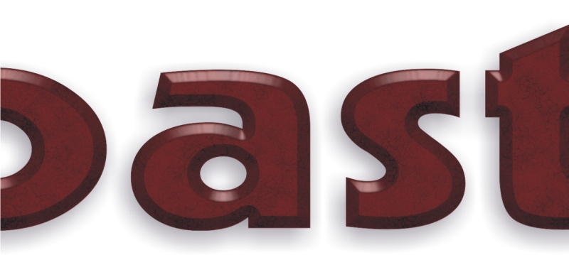

  10. Rollie
    Rollie Very Active Member
    1,651
    36
    Dec 20, 2007
    Ontario Canada
    Corel Draw and Photopaint.. and about 60 seconds
    No plugins

    Where are you at with it One UP?
