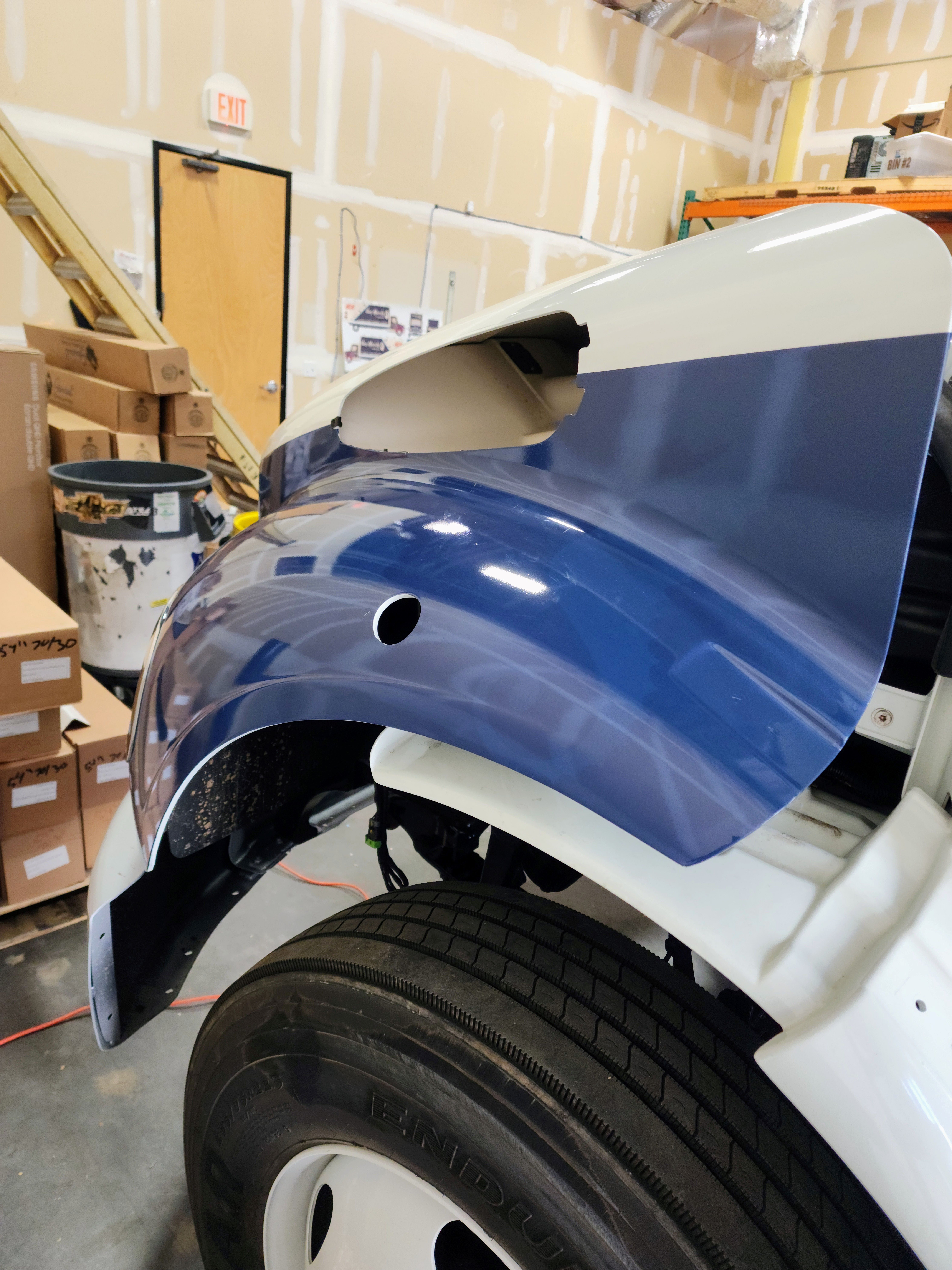

I've got several 1650 customers who wrap vehicles all the time. It works quite well. I've even got customers who do cheap vehicle graphics WITHOUT laminate....the inks don't scratch....
