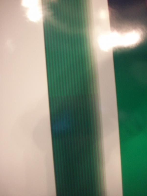

  9. gators2001
    gators2001 Member
    348
    Jul 30, 2006
    first time ever putting a pic on maybe it worked

  10. Bigdawg
    Bigdawg Just Me
    7,459
    133
    63
    Jun 8, 2005
    Sunny Florida
    That looks like bad banding.. I would clean the heads and then run a medium clean on it. Also look at the material feed.. try pre-feeding the material so there's no drag.

  11. gators2001
    gators2001 Member
    348
    Jul 30, 2006
    no thats not it if i dont try to print one panel it prints fine . Just printed the passenger side all at one time no problem. just when i try the one panel.

  14. Bigdawg
    Bigdawg Just Me
    7,459
    133
    63
    Jun 8, 2005
    Sunny Florida
    Then that's just crazy... which I know is no help at all. But I swear it looks like banding and not printed stripes. What file type are you ripping and what program did you generate it from?
