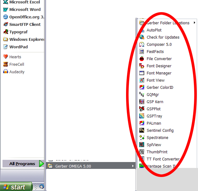

If what you are saying is so then you do not have anything close to a complete install. Attached is a pic of my Gerber Program Group. As you can see there are a number of programs in the group. They are not quite the same because mine is version 5 but there should still be a number of such links as are being shown.
If you do not have this group, then you need to create it. The best way to do that is to do an uninstall and a correct, reinstall of version 1.5 followed by installation of maintenance upgrades 1.54 and 1.5.6. If you aren't up to all this, you should hire a competent computer technician to do it properly for you.

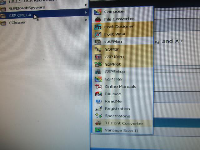

Thanks Again yes I went to school for Networking took a little Programming and A+
Just the program is all new to me this what I have.
If this is not good then should I uninstall everything?
Install 1.56 then 1.54?

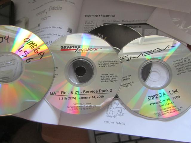

What I'm not seeing there is the Omega 1.5 CD which, as far as I recall, is needed if you are going to do a reinstall. The order to install is 1.5, then 1.5.4 then finally, 1.5.6. If you install them out of release order it won't go well.

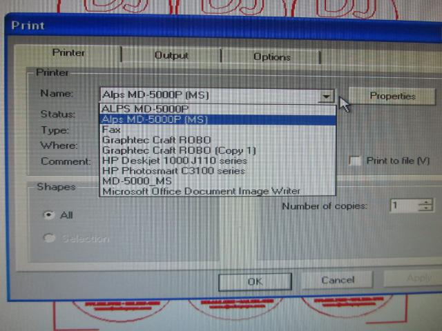

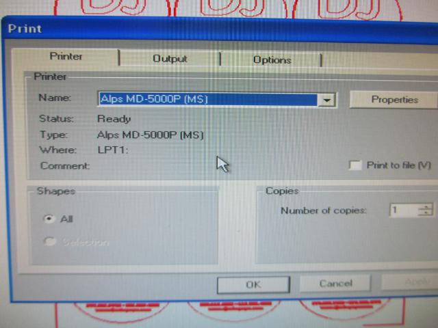

I got it uninstalled everything and reinstalled again I am now able to import AI files.
But I can not see the Gerber Printer it is set up as LPT 2
But I get LPT 1 when I go to print.
Is there a way I can change the port to LPT 2 in Omega?

One doesn't use the Windows print setup for Gerber printers or plotters. You install each through the GSP Tray. Once done the procedure for outputting a job is also different ...
From Composer you either Output All (Shift +F11) or Output Selected (Shift +F12+. This then will open the Gerber GSPPlot program where you can control all the print and plot parameters of the production of the job. Once you are setup in GSPPlot to run the job, you simply press F10 to send to the Edge and F8 to send the job to the plotter (after you align the printed target with the plotter bomb sight).
