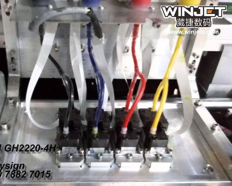

David,
I noticed that many of these advertised now have the Ricoh GH 2200. Perhaps this will still be a stumbling block. Are you familiar with this head? Seems to be directed at a competitor to Epson.

I am Artbot. It is an inexpensive head made by Ricoh for that purpose. It was commercialized last summer. It is an inexpensive head made for aqueous and solvent ink only, and is constructed out of plastic and silicon only (no metal). It is not supported for UV by Ricoh. It also does not have a heater in it.
Great head, but limited uses. Primarily solvent/fabric printers. In China, if they do not have a license, they buy 100.00 desktops and harvest the heads. The lack of a court system allows them the ability.

To me, as for DX5 heads, Epson is to blame, they are practicing price gouging whenever possible. I once took apart an Epson 1000 head unit. Under the Epson head rank sticker, I found a Roland head rank sticker, then under that Roland sticker a Mimaki head rank sticker. The "OEM commercial" vs. "home" head is a fallacy to simply demand and additional $1000 retail for a desktop head.
As for the GH head, it looks promising. $400 a channel, no heating is just one more thing that won't degrade over time. ...then inside of an Epson head is some kind of extremely brittle laminated metal. The GH could be a lot more durable.
