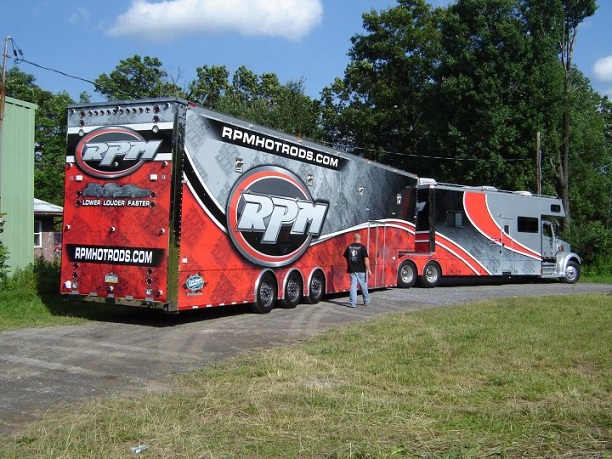

3551 Has its place. The truck & trailer pictured is all done in 3551 & 290G. Given the amount of material used, the savings was significant and it performed well. On an Express, I'd definitely use 3951.

That wrap is Freakin' sick!!
