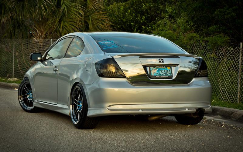

CSOCSO
I don't hate paint, I just overlay it.
Btw that is a 3M chrome on my scion. Pssst.. its not on the market yet!
It was thick.. laminated IJ40 kinda thick.

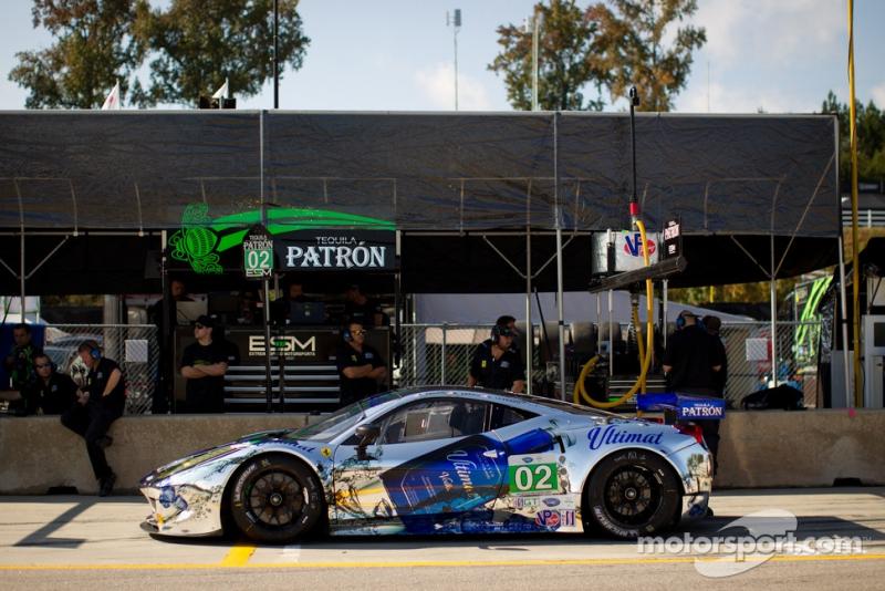

ESBG
project debuting this week with Avery's chrome :
