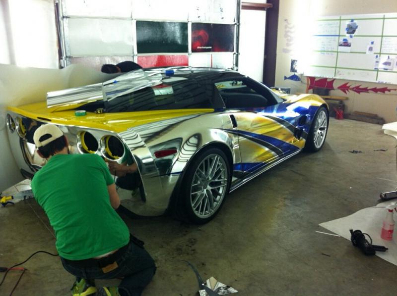

Vette wrapped with Avery Chrome... Printed, and applied thanks to carswraps.com

I like that seems i need alot of heat with this stuff i had a bit of trouble on just the mirrors. We got to completelly disassemble our crossfire want this to look good.
