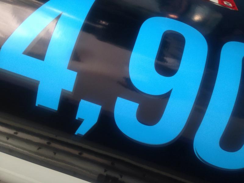

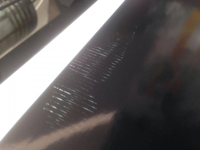

Lines scratch
So were back on business :)
With a pretty good quality but with lines scratch (cf pics)
The media is well armed with a good tension without irregularity of position.
Solventinkjet
DIY Printer Fixing Guide
Those look like head strikes to me. Make sure you are using the media clamps on each end of the material. They are the flat metal pieces that slide along the platen. If they are not present on your machine I would recommend getting some. If you are using think material, change the head height to high.
b6hs
Sign
Yes thats it - but media clamps are optionals they are only recommended for thick medias. (i only use one on left side i have a brand new for right side but screws are very small and i dont have some)
In fact that was due to the head plate when i replaced it i put it twisted..
Thanks vander
