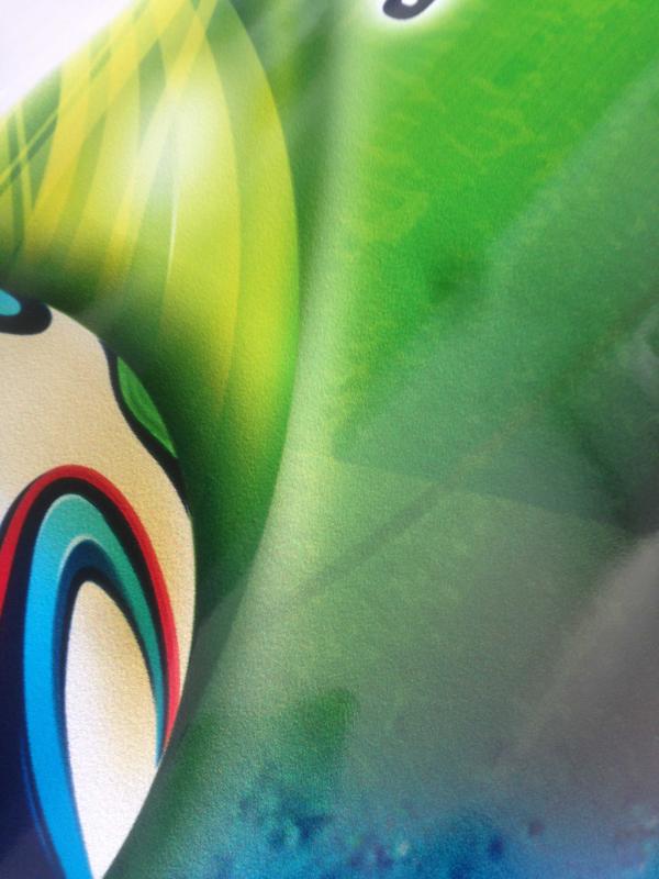

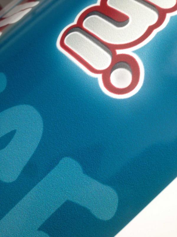

As i told i successfully combine print and cut by deactivating y detection mark repers and i get around this issue for the moment so as to catch up the production delay.
BUT i have some grain picture as show on attachment .(upload won't work)
All is new on the machine and i have performed the drop position adjustment.
Any ideas ?

graininess
Any ideas ?
I have the exact same problem as on this thread http://www.signs101.com/forums/show...5-head-installed&highlight=cjv30+slant+adjust
i'm trying a slant adjust but wow...
If someone can help me thanks
