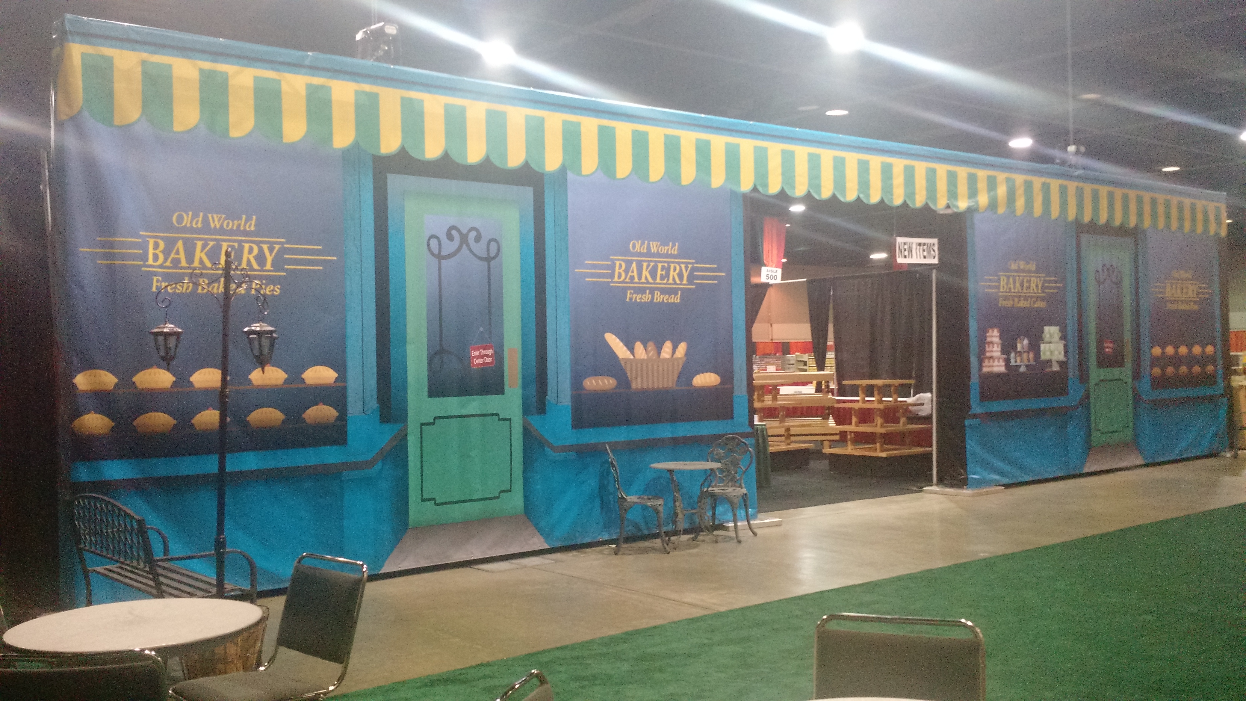

I think it's time to upgrade print equipment. Banners have been pretty scratch resistant since like 2010. UV and Latex are pretty durable. We used to regularly do 12x50 and 12x25 backdrops that'd get walked on, folded, and dragged all over during installation to the trusses.
