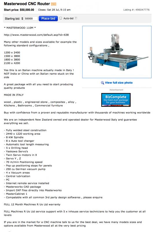

Cool, so it really does sound like I am not going to go wrong in getting one of these machines.....
Here are the two that I am looking at

with that kind of money those you posted are, you are better off buying a used multicam 6x12 in great shape. Always buy the biggest table you can afford up front. almost anything else you can upgrade later
