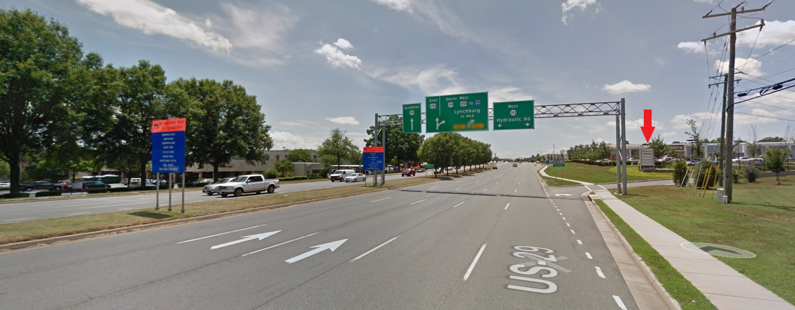

The only time that I have done this was with a sign located in a dark skies ordinance. Backgrounds had to be darker in contrast to the letters. It turned out nice, but very subtle. Top speed on this street was 15mph and mostly walking traffic, so it worked for the environment. My point...there is a time and place for some of these things.
However this is on a major road, biggest in our city.

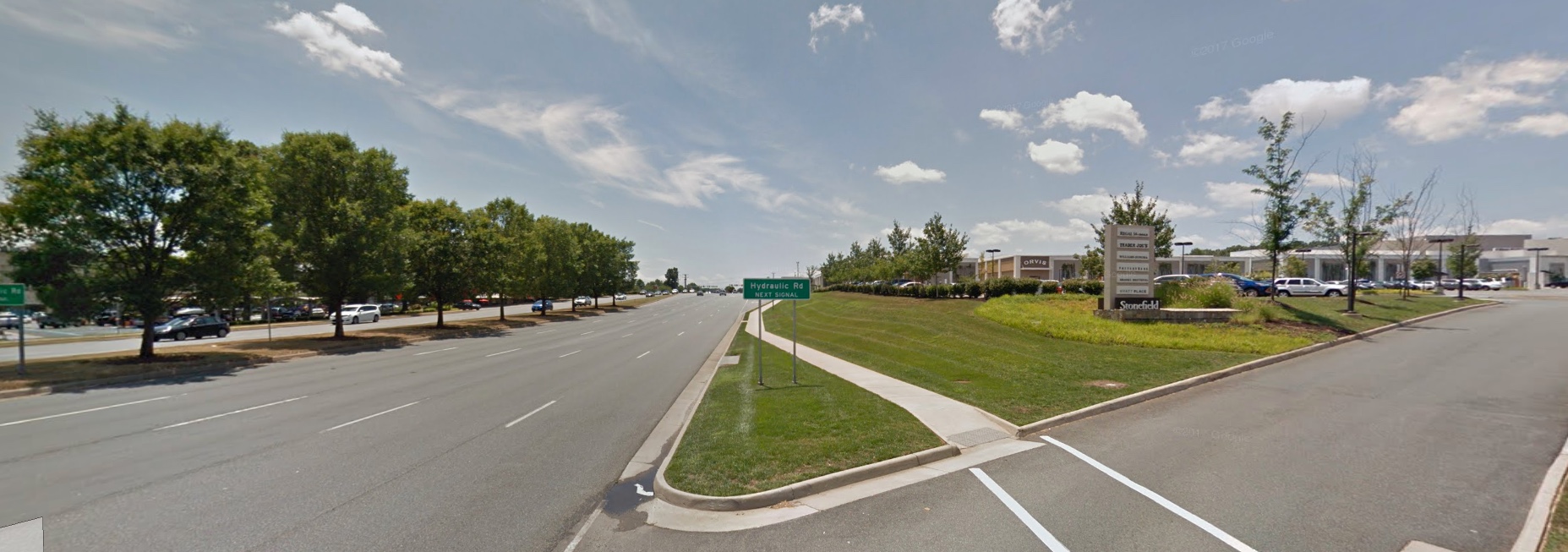

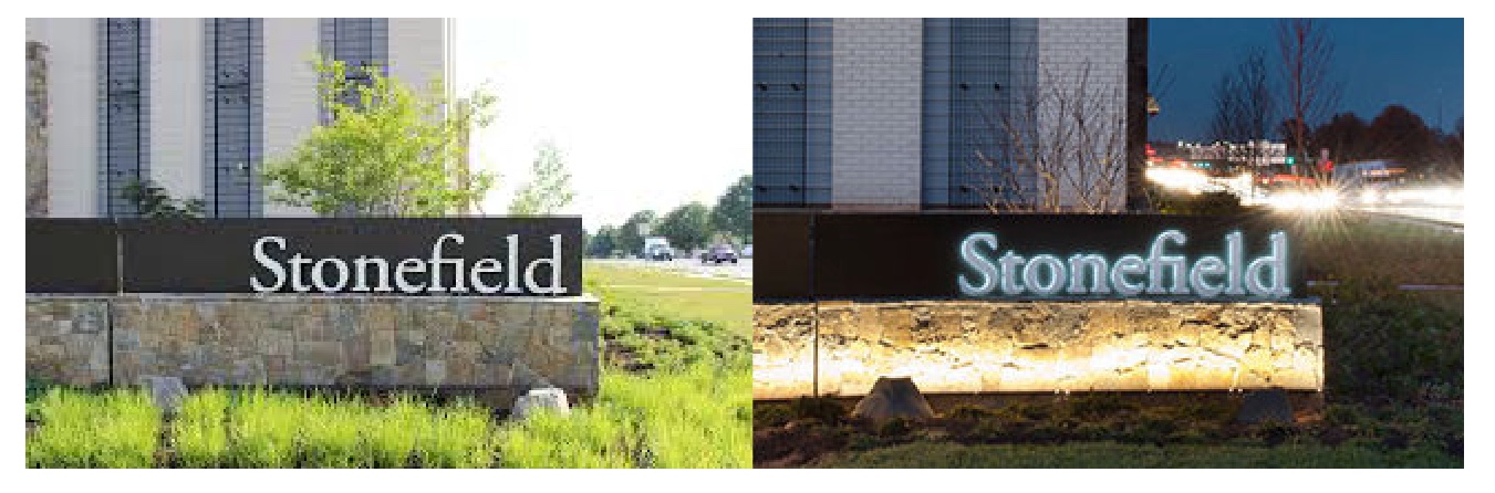

Looking at the overall pic, it's obvious to me... the sign is too small - especially from that highway, illuminating a letter that small and expecting it to be conspicuous from that distance was a stretch to begin with.. I found a pic of the other sign, it also looks to be like that have too much ambient lighting from the uprights flashing on the stone. I personally think it's a combination of a few things... baffling the uplighting and pinning the letters off more might help, but the sign is too small...
Around her, that sign and letters would me 2-3 times that size...
