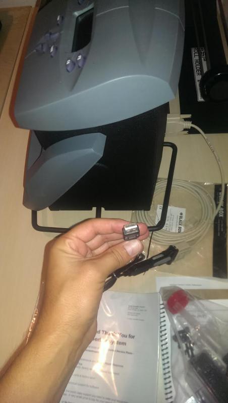

Hello,
I unpacked and set up my envision cutter today. Yeah Me!!! LOL!!!:thumb:
Now I am having trouble connecting the cutter to my computer. I am on a lab top so I have to use the usb converter.
I get the following error:
Currently, this hardware device is not connected to the computer. (Code 45)
To fix this problem, reconnect this hardware device to the computer.
I can not find the drivers so this will work. Any help you guys may be able to provide is appreciated.

i believe with that cutter its best to use the gerber supplied cable
Thanks for your reply, I am trying to do that now but the computer says I don't have the correct drivers. However, I can not find them on the Omega DVD or online.
Next thing is to call Gerbers support tomorrow. Hopefully they can help me.
rfulford
The cable gerber supplies is a null modem serial cable. You may be able to get around using it via emulation or an adapter but the plotter needs to think its there. I bought my plotter used without the cable and wound up with this configuration. I use a Manhattan serial to USB adapter attached to an old serial cable with the correct pins attached to a null modem adapter plugged into the back of the plotter.

Incase anyone else has this problem I found the solution.
1. I downloaded the driver from this url to my desktop.
http://www.gspinc.com/service/software-downloads
"UsbInterfaceCables.zip "
2. I opened Device Manager from Control Panel in Windows.
3. I connected the usb cable to the usb port on the computer.
4. Device manager gives an error and I followed these instructions.
Right click on Other Devices then USB Serial Converter to bring up a menu as shown below. From thedisplayed menu, select Update Driver Software. This then displays the option for an automatic search ora manual search.
5. I selected the driver folder from the zip file I downloaded.
6. In the install settings in GSPLOT I selected COMM3.
All this time I was missing the driver, once I installed the correct driver it told be it was COMM3.
Even though you are connected via usb, the computer is reading it as serial port Comm3.
