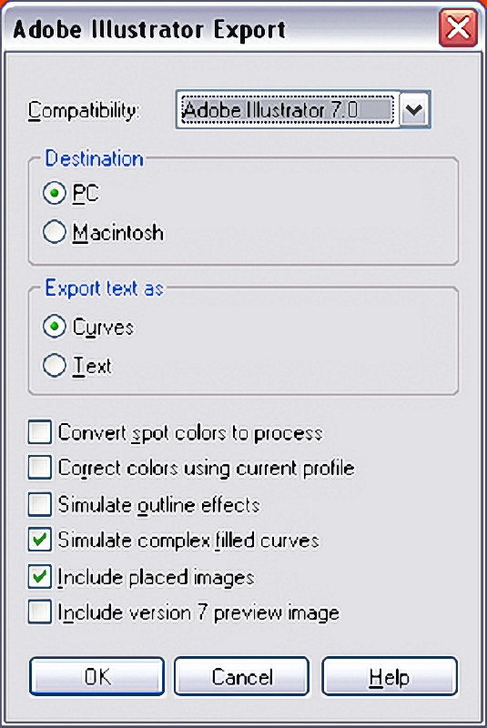

Your format not supported error message sounds like the exported file
was to new of a version. Even though your Flexi is new and you’re Corel
is version 11 it still takes awhile for Flexi to catch up.
I have had the best luck with the newer versions of Flexi exporting vector
files from Corel 11 as Illustrator .ai version 7 (used to be .eps would play
better with Flexi). Then importing the .ai file into Flexi.
I would not recommend the copy / cut and paste method as there will be
quality issues not to mention the un-necessary use of system resources.
