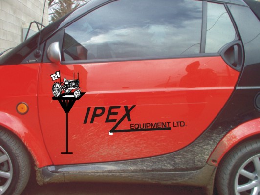

    Hope i can explain this , I am new tp Corel and using version 12, I would like to know how i can place one image on top of another image and make the top image take the back ground color of the rear image.. I want the white on the tractor to be clear or see though so it is orange.. Hope you can under stand this.......:thankyou:

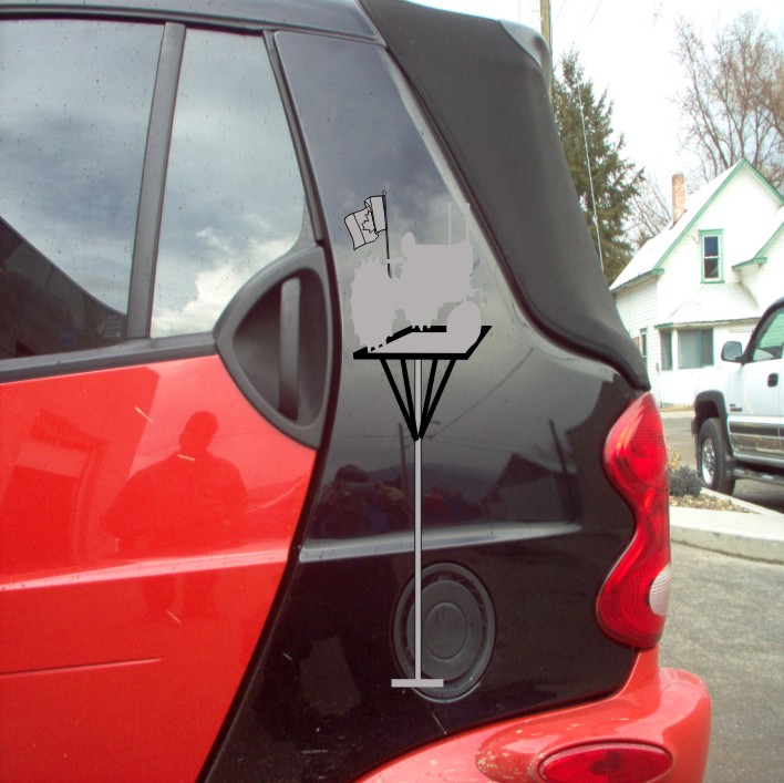

    Heres what I am talking about with the fill problem

  10. learned the hard way
    learned the hard way Active Member
    544
    Jan 3, 2006
    It looks like you welded it instead of combining. If Shovel's instructions worked for you before, just start over and turn the black to gray before you combine.
  11. xtremegraphics
    xtremegraphics Member
    277
    Jul 22, 2005
    Thats what happens when i turned the black to grey... It completely fills the tractor grey instead of just the outlines...
  12. Shovelhead
    Shovelhead Major Contributor
    10,882
    16
    Dec 5, 2003
    when you combine.....
    you're whole image becomes one object and takes on one color
