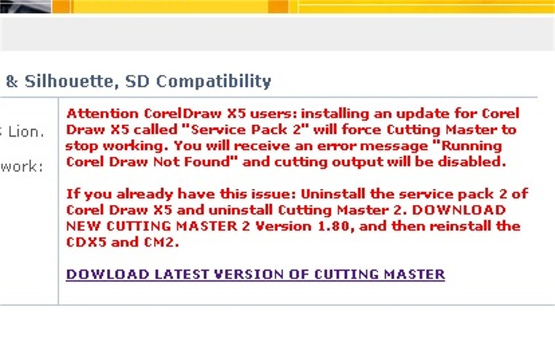

Dammit now I can't get my cutting master to launch. I uninstalled Corel 12.
Now when I go to plot on my CE5000-60 I get a pop-up that says "no active corel draw running". I rebooted twice and re-installed Cutting Master.
I should have left well enough alone, I have files I need to cut and get out the door.
Jillbeans
How do I uninstall the update? I think it's the culprit.
(see pic from Graphtec site)

Jill I found this over on the Corel forum FYI, Cutting Master 2 v1.81 has been released, and it seems to work with X5 and service pack 2. make sure your version is at least 1.81 and you should have no problem!
Jillbeans
Uninstall/reinstall both thank God it's working again.
