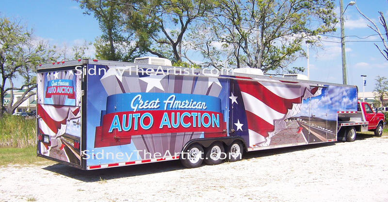

I invested in Corel quite some time ago (maybe 20 years) but also used Illustrator. When my business really started to expand and I began investing in "tools" needed in the sign business I realized back then that CorelDraw could output to my cutter and my printer(with No Rip program). CorelDraw X8 really is impressive...I definitely recommend it. Here is sample of a project printed without a Rip program....Just Corel:)
attachment.php
That is impressive,.... and reason enough to use Corel software. Is the process going to large scale print through Corel relatively painless.... are there any drawbacks on output?

I personally did not find it difficult to transition over to large scale printing, but that is my experience. The Top 3 major pluses for me is ....
1)the ability to work on large scale designs from within Corel and not do 1/4 scale at "X" dpi or "X" scale at "X" dpi.(some projects will need to be scaled down, but I have done 20' designs at full scale)
2) consistency in color output
3) quick transfer speed (from Corel to printer)

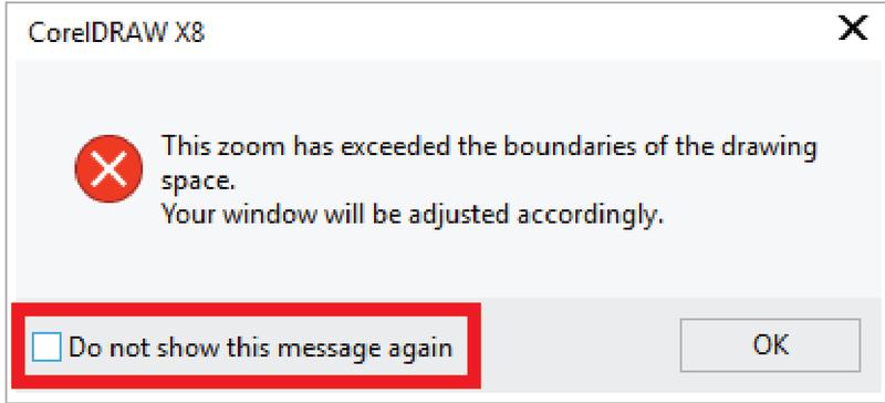

This checkbox ALONE would be worth the $200 upgrade cost for me. This drives me NUTS. Why did it take so many versions for them to implement this?

That annoying message you get when zooming out too far is able to be disabled now. I hated that message. A dark UI is included, window dressing but some people will be glad.
