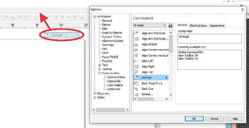

It's not hard at all;
1. find the greyed out "Tools" tab
2. select "Customization"
3. select "commands" in the pop-up window
4 in the drop-down select "Arrange" (I skipped "file" for now to make it less confusing)
5. find the command; "Arrange" and drag it to where you want it. (at first it will be floating, you will have to re-drag them to your toolbar)
6 Do the same for: File, Edit, View, Layout, Effects, Bitmaps, Text, Table, Tools, Windows, Help
7. click OK

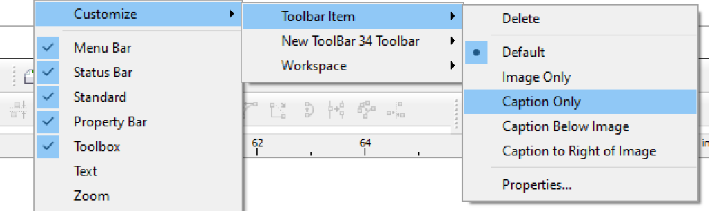

8. right click on each toolbar item, select; Customize-Toolbar Item- Caption Only
