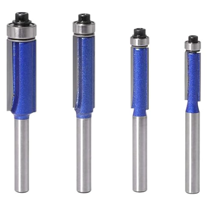

Clamp the coro to the mdf, stick a router bit with the little wheel so it just clears the coro,
and follow the shape with a basic router or one-hand trimmer.

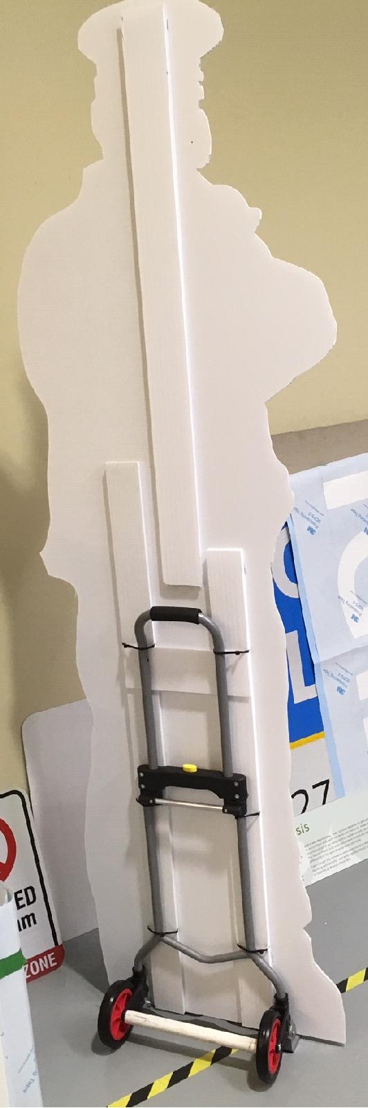

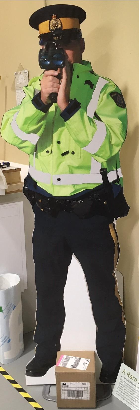

Here's the actual 'irregular' shape that I did a batch of ...from 10mm coro.
