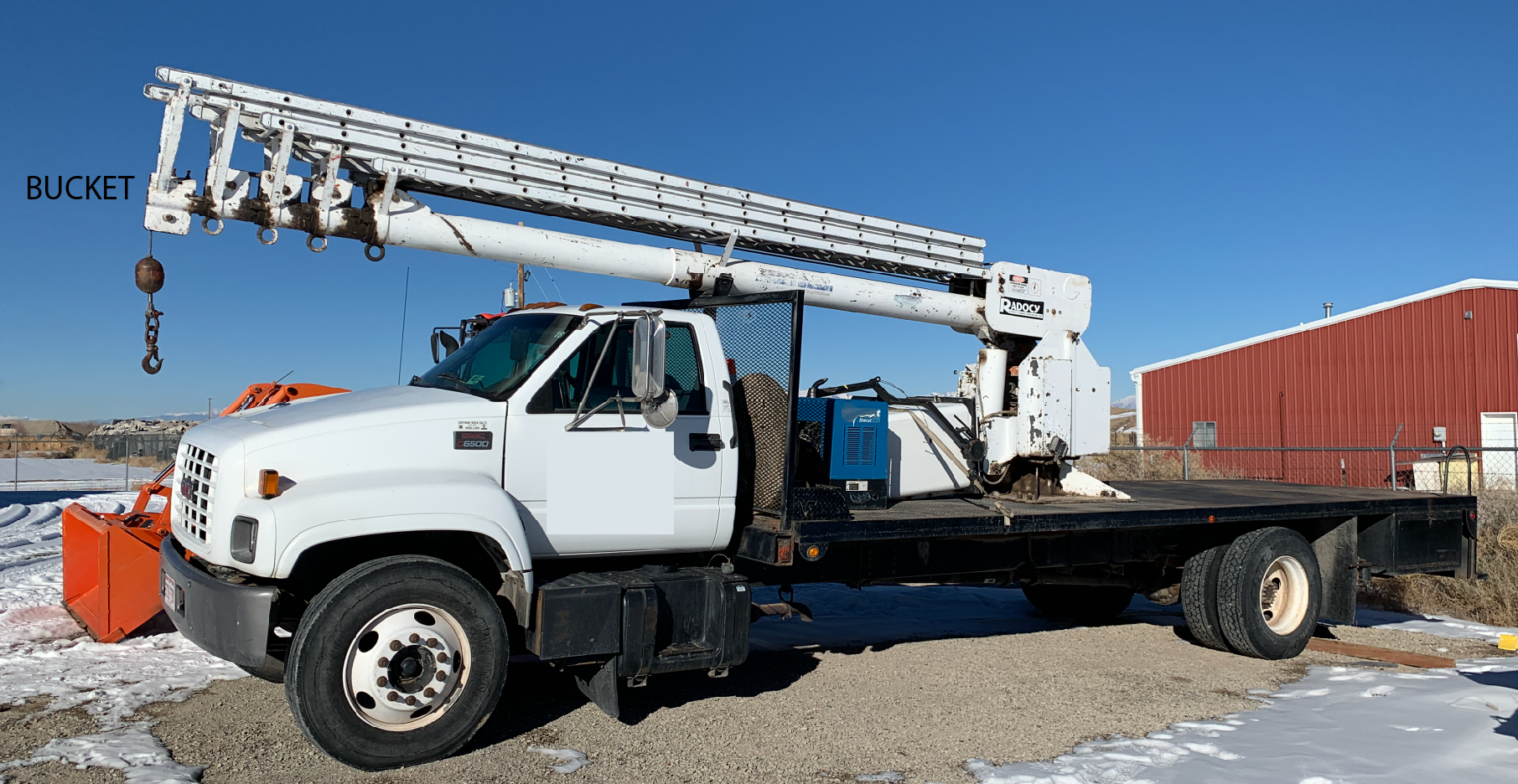

My first job in the sign business included servicing out of a 45' Skyhook very similar to this Radocy, by myself. Load tools and parts in the basket, point the basket where I thought I needed it and climb that ladder. In 8 hours time I would climb that ladder dozens and dozens of times. The crawl from the ladder to the bucket and back again took about all the nerve I had in me. I also worked Skyhook 65' & 85', though always two men. The 85 footer with a 25' jib put you up there at 110'. There was bounce! The rotator gear was worn and it would swing 8-10 feet left or right at the slightest nudge of the switch. Just hold on til it stops rockin'. We would try to point it where it needed to go before we extended.

Enough with the nostalgia. Think of this truck as a crane, that will do service in a pinch. It will lift most poles and head sections in it's height range, which I'm guessing is close to 80'. If your in a locale without a good crane service company, you can also set AC units or even trusses for a builder, whose a good client, once in a while, if need be. This truck will also allow you to reach parking lot lights over 35' that the Altec A200 or similar 'Cable Truck' will not get to. Some Hi-Rise structures you be able to reach also. If the cabinet is big enough to climb in and service from the inside then this trucks great for you. Remember, It's still a two man operation though.
This truck is not an efficient rig to do routine lighting service of smaller cabinet signs. Again, it requires two men. Unless you employ a highly gung-ho 25 year old who Crossfits in their spare time and has no fear of heights. As far as wall installs, consider this: a 35' square tube cable truck can be eased up, down, in, out, or rotated as little as 1/2" - 3/4" when you need to be just right there. More matter how talented the operator on his rig is, with it's age he's gonna move yo around in 2"-5" increments, much more fully extended.
Seriously consider what yo want to use it for. If it's lifting and service over 35', then good deal. This would be a super great truck to have as a second, behind something like an Altec AT37 (42') fore everyday service and wall installs. As TexasSignmaker said, it usually takes two trucks for a head section.
Hope my ramblings helped and Aahh for Nostalgia's sake buy this rig so it will stay on the road and in the air!

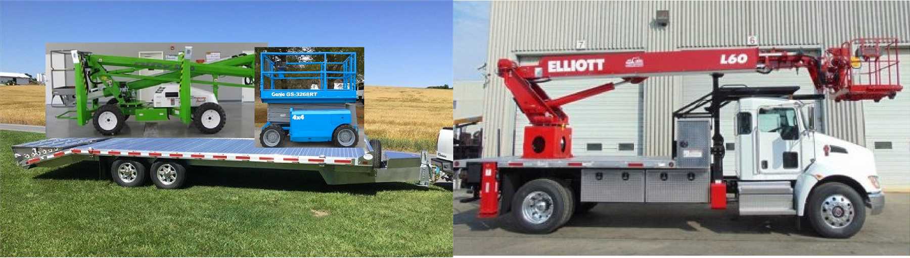

Me as well, getting a DOT number and physical is no big deal and essentially free, a bigger lift and trailer plus a big truck MIGHT put you past 26,000 but I doubt the setup was that big? I have thought about going with an all-terrain scissor lift and trailer, it is so nice to have the work area and stability. The problem is that even a curb or small slope severely limits you and you end up renting a towable anyway...

Can always get both. Terrain permitting, scissors are the best to work from IMO

We just bought a 2017 L60 Elliott. The idea of having a jib in the basket is a whole new experience for us!
