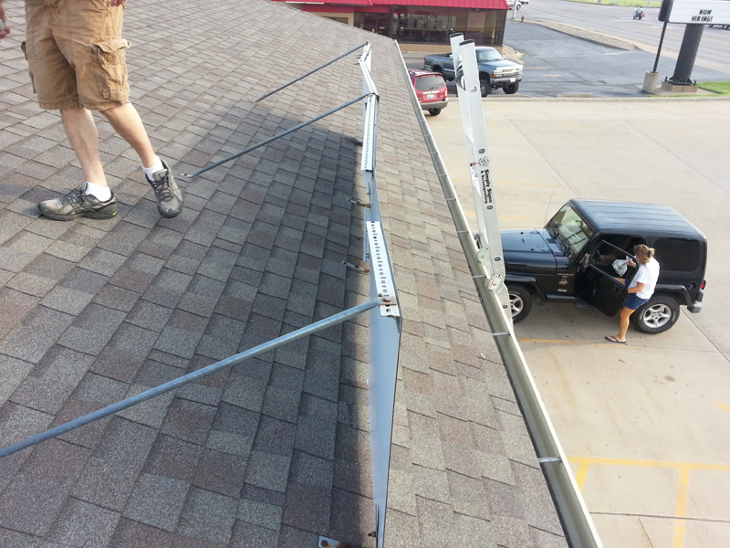

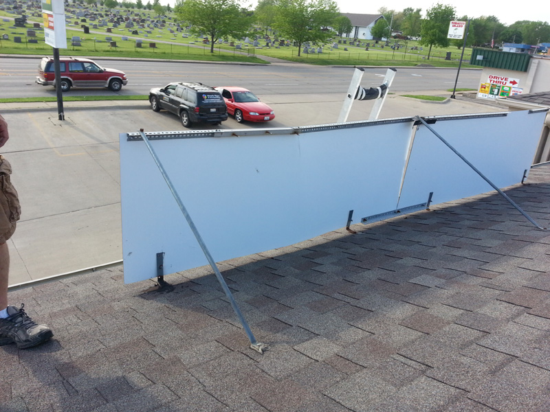

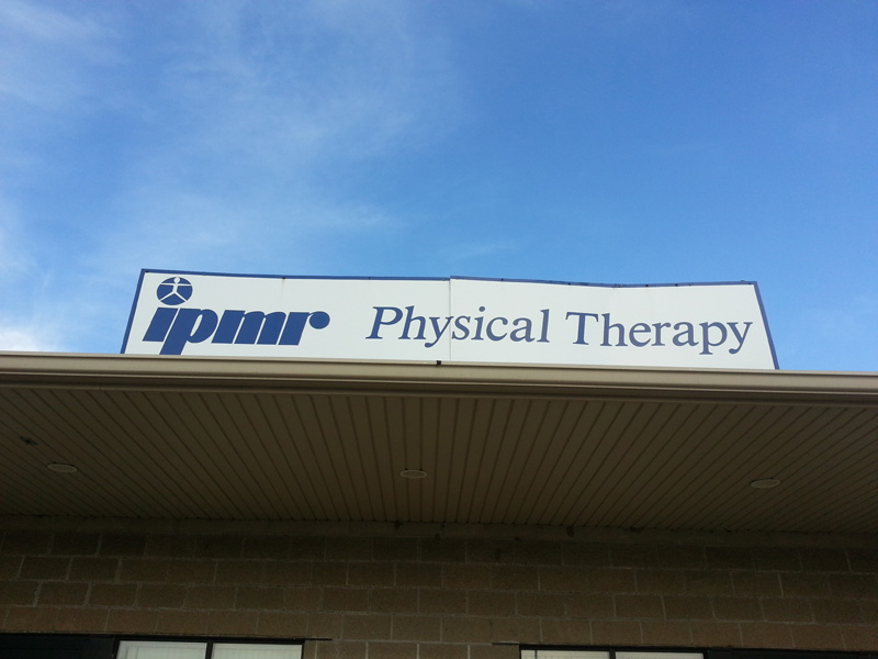

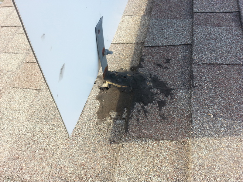

We got called to this location to check out a "broken sign" that needs "repair". Upon arriving at the site and taking a closer look, we realized this sign needs more than just repair, this sign needs completely replaced. The following pics show the condition we found the sign in. I can't believe someone actually got away with mounting the sign to the roof like this. We plan on submitting a bid to reconstruct the sign as well as the frame that it's attached to. I'm sure this topic will get a lot of discussion. It's been 24 hours since I saw this thing and I'm still shaking my head in disbelief.

I agree. It's most likely not the sign guys fault. Most likely it's the third scenario you described. However, I will probably find out exactly how this happened as soon as the company representative gets back to me next week. This sign has managed to survive this way for ten years but recently sustained the damage that you see to the panel on the right. They asked me if it should be taken down immediately even before we make the new sign and I said that I certainly would take it down if it was up to me.
As far as putting food on the table, we bid this job plenty high in my opinion and we will most likely get it as we do a lot of work for this company. If we were to do it the cheap way I would be more worried about getting our butts sued. Rest assured this situation will not happen with us installing the sign. We will have a licensed contractor with us to make sure everything is properly attached to the roof and sealed around the holes. As far as building a framework to mount it, I'm planning on building a solid rectangular angle iron frame and having triangular mounts so the sign frame itself takes the wind load and the load isn't supported solely by three bolts in the roof as it is now. The way whoever did this job is just wrong in more ways than one. I don't care how bad I need money, you either do a job right or you don't do it at all.

I don't know, I think it has the earmarks of someone who knew a little about installing signs.
Enough to know that it should be installed off the roof a few inches, that slotted angle is used
and they knew conduit with flattened ends can be used as braces.
Like the old saying goes "a little knowledge is a dangerous thing".

The problem I see here is his roof is probably leaking.
There is a reason only one bracket has a patch of tar on it.
Once you do something with this sign even replacing it...if you don't seal the roof up good...later he will come back on you for roof repairs.
You better keep these photos for when he tries to sue you for his roof leaking.
