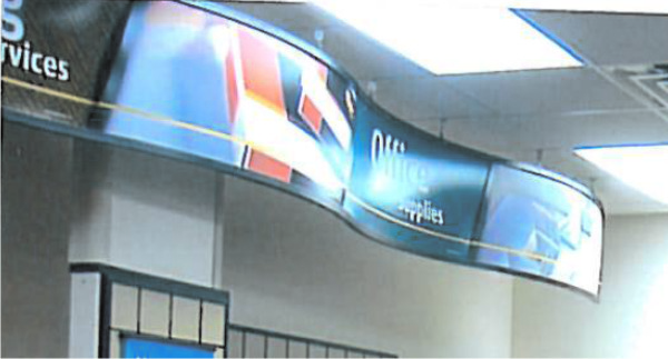

Does anyone know where to find a curved sign hanging system like this? Not sure if it's plastic or metal.
TIA.

I'm sure I can devise a way to make my own but I'd rather buy something ready to go. My time is worth more than the time it would take to put it all together. I'm willing to pay for the convenience of a pre-made solution.
Thank you anyway for the ideas thus far.

It looks like Foga or similar brand of extrusion. There's another Brand, but the name escapes me at the moment.
If you know the measurements/radius, you can email the drawing to Outwater Plastics and they could fabricate it for you. All you would have to do is assemble and install.

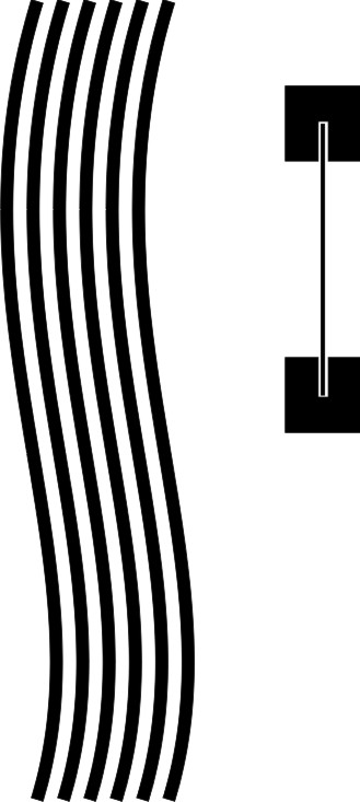

Using 3/4" or even 1/2" PVC, route an 1/8" center grove down the center of a curved line on the router table. Flip them for the tops so they mirror the bottom. Use cement of silicone to embed the print in the channel.
Shouldn't take very long to route and since it's PVC, they can be painted any color.
