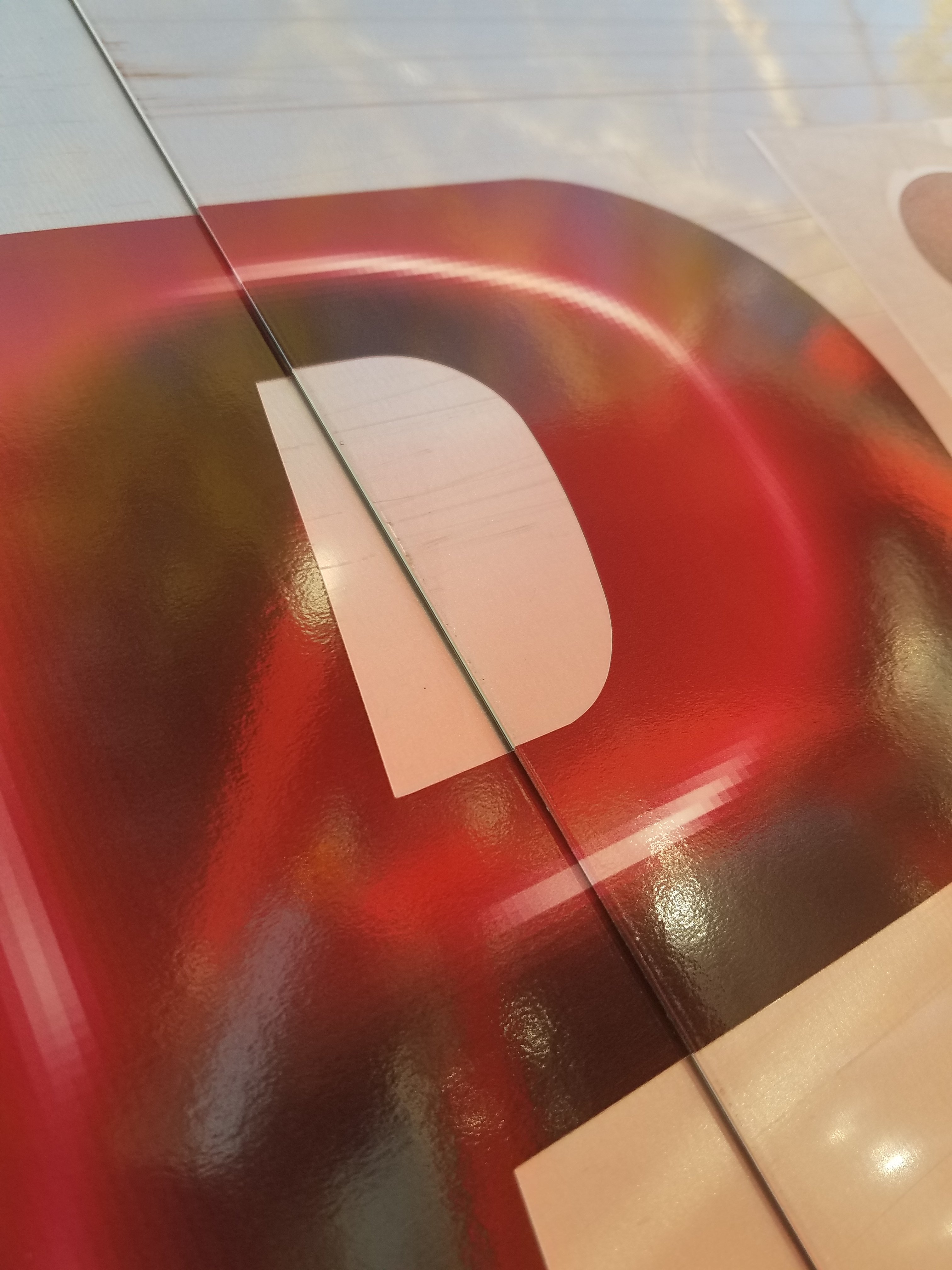

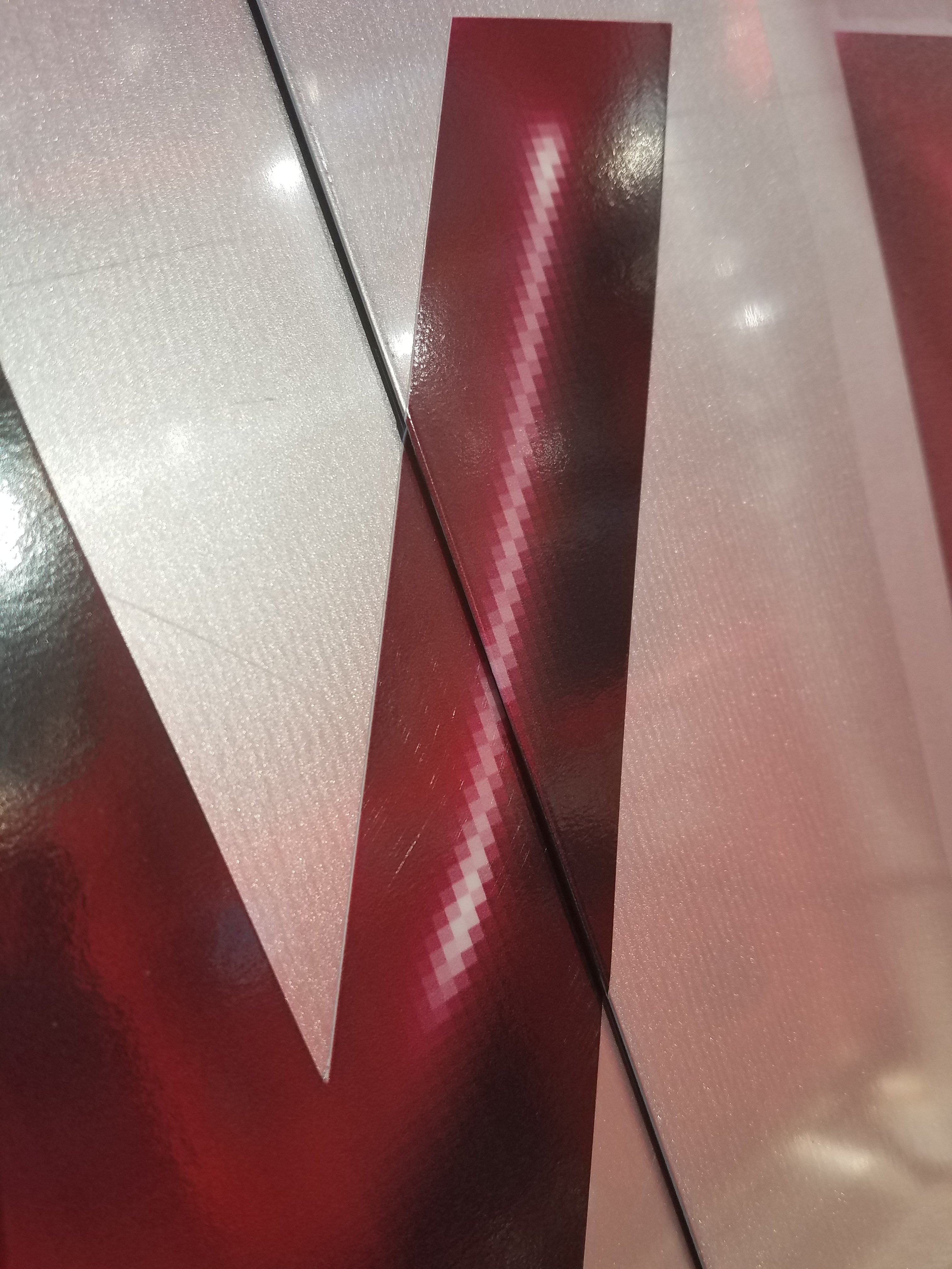

just curious what everyone else does?
laying cut vinyl on trailer and i cut the vinyl that overlaps the panels. i have found in the past from the movement of the panels the vinyl will lift and get dirt underneath causing the letters to fail.
when i cut them you do get a little shrinkage but a lot less issues .
just what i have experienced.
(also i and using cast sign vinyl or cast wrap vinyl/lam )

+1 cut it. the failure from shifting panels looks a LOT worse than a little edge-curl or "gap" in the graphic.

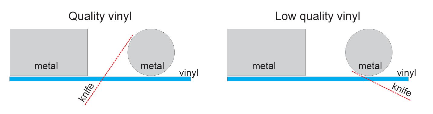

I did it the same way, never had any problems. If you use quality vinyl, you can cut it at suchangle, that some material will go around corner. Make sure you use heat blower. I im doing some short term installation, and dont use quality vinyl, i cut it in that way, that no vinyl can get around edge. Acually edge is visible.
