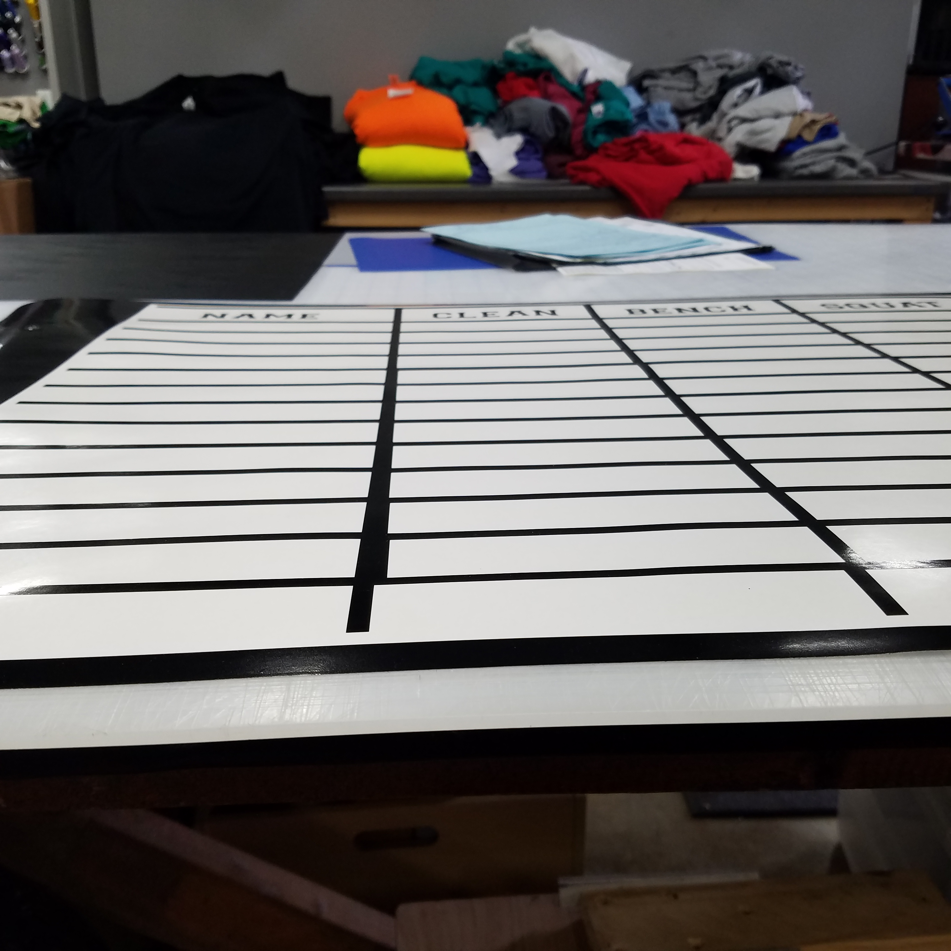

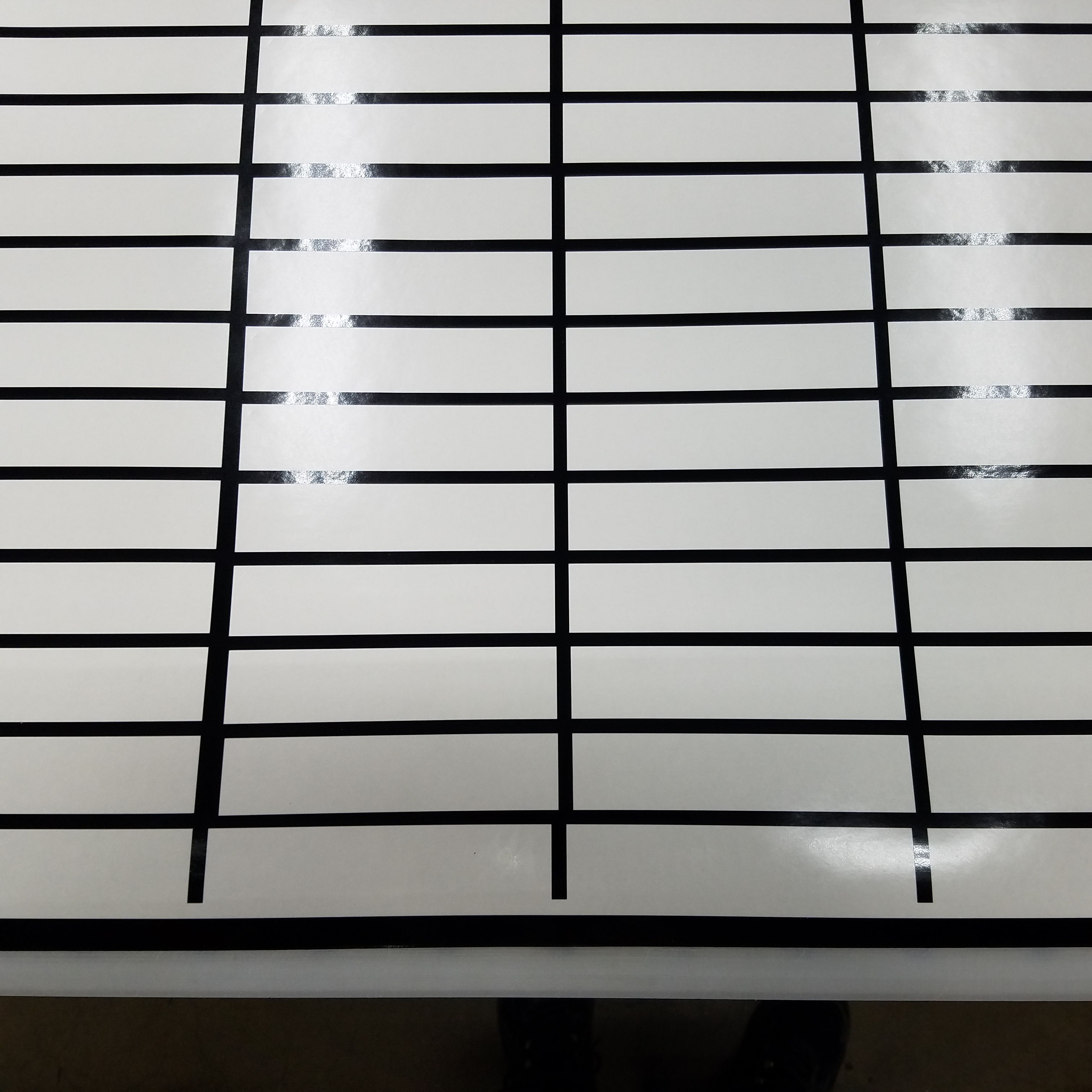

    I have a Roland Sp 540 V and I'm having issues with the cutter keeping registration whether it be regular cut vinyl or printed vinyl with registration marks. I know that the vinyl is tracking straight through the pinch rollers, so that's not the issue. Attached are some pictures of what I'm talking about. Any help or suggestions would be greatly appreciated. 20190311_150154.jpg 20190311_150213.jpg

    Holding up the material as it feeds in and out can help alleviate some of these issues. It's not ideal, but it works (mostly).

    I just cut the same file on our Roland Camm 1 Pro and it came out perfect.

    I also have a SP540V and it has trouble with repeating accurate cuts. Solved all my cutting issues when I bought my Summa.
