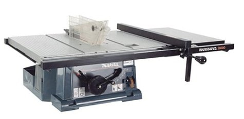

With a little 'tabletop' table saw and a fence, you could knock them out in 1/2 a day.

With a little 'tabletop' table saw and a fence, you could knock them out in 1/2 a day. View attachment 133485
Thank you for your reply! Since i cant really use the saw in my shop, getting my supplier to do it is probably my best option indeed.
