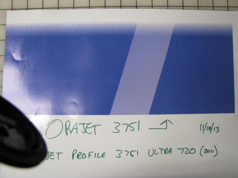

Well, I had high hopes of resolving this issue, but it appears even with the most recently updated profile from Oracal, this stuff just won't print on my VJ 1604.
THIS is how my roll of 3751 printed using the most recent 3751 profile..
Notice the banding, speckling/gritty adn washed out print quality?
(Sorry this pic really doesn't do justice to how bad this stuff really looks in person.)

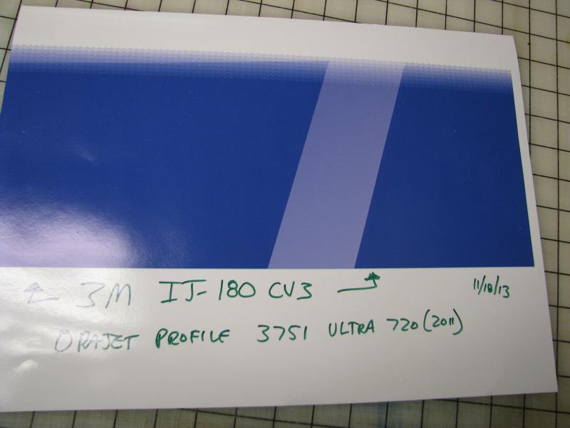

Using the same ORACAL profile here is how IJ-180CV3 prints on my machine...

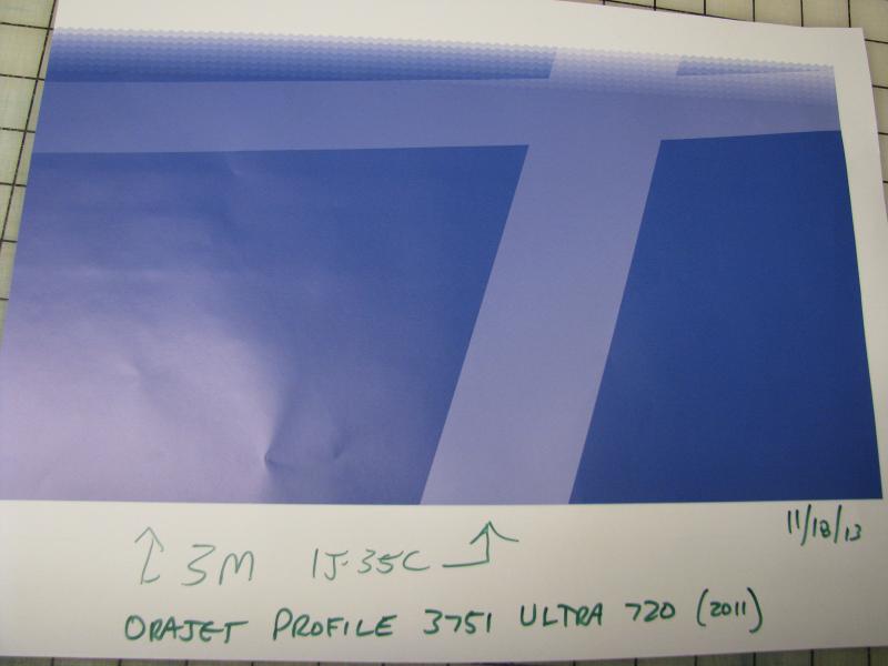

And here is how IJ-35C prints using the same ORACAL profile...
So my conclusions lead me to believe that I either have a bad roll of material, or this stuff is problematic for many users...

Sure did. My Fellers rep put me in contact with the regional sales person who then turned over my info to Timothy Wright a product support specialist. Tim contacted me yesterday morning and sent me the newest updated profile for this material. Unfortunately, even that failed to produce usable results - as you can see above. Funny thing is, using that Oracal profile produced much better results both on IJ-180 and even IJ-35. Tones were smooth and color was consistent throughout. The 3751 printed very gritty/blotchy and even was causing light/dark banding.
I really wanted to like this material in hopes we could move away from the IJ-180, but from what I've seen I can't see it happening. Tim was going to send me a sample roll in hopes of proving I got a bad roll. Unfortunately, I had to scrub this and purchase a roll of IJ-180 to complete the job because we're installing this wrap on Friday and don't have time to waste.
