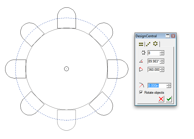

make ellipse (table)
select ellipse
hit "S" key
hold "SHIFT-OPTION-COMMAND" drag and make outer ellipse.
make chair elipse and make sure it is within outer ellipse.
select the "outer circle" and the "chair ellipse"
hit "R" key "RETURN"
"ROTATE" window will pop up, type in "45" for your rotation value and hit the "COPY" button.
it will make another chair at 45 degrees.
hit "COMMAND-D" 6 times, remove the outer circle and viola, you are done.
less than 30 seconds
