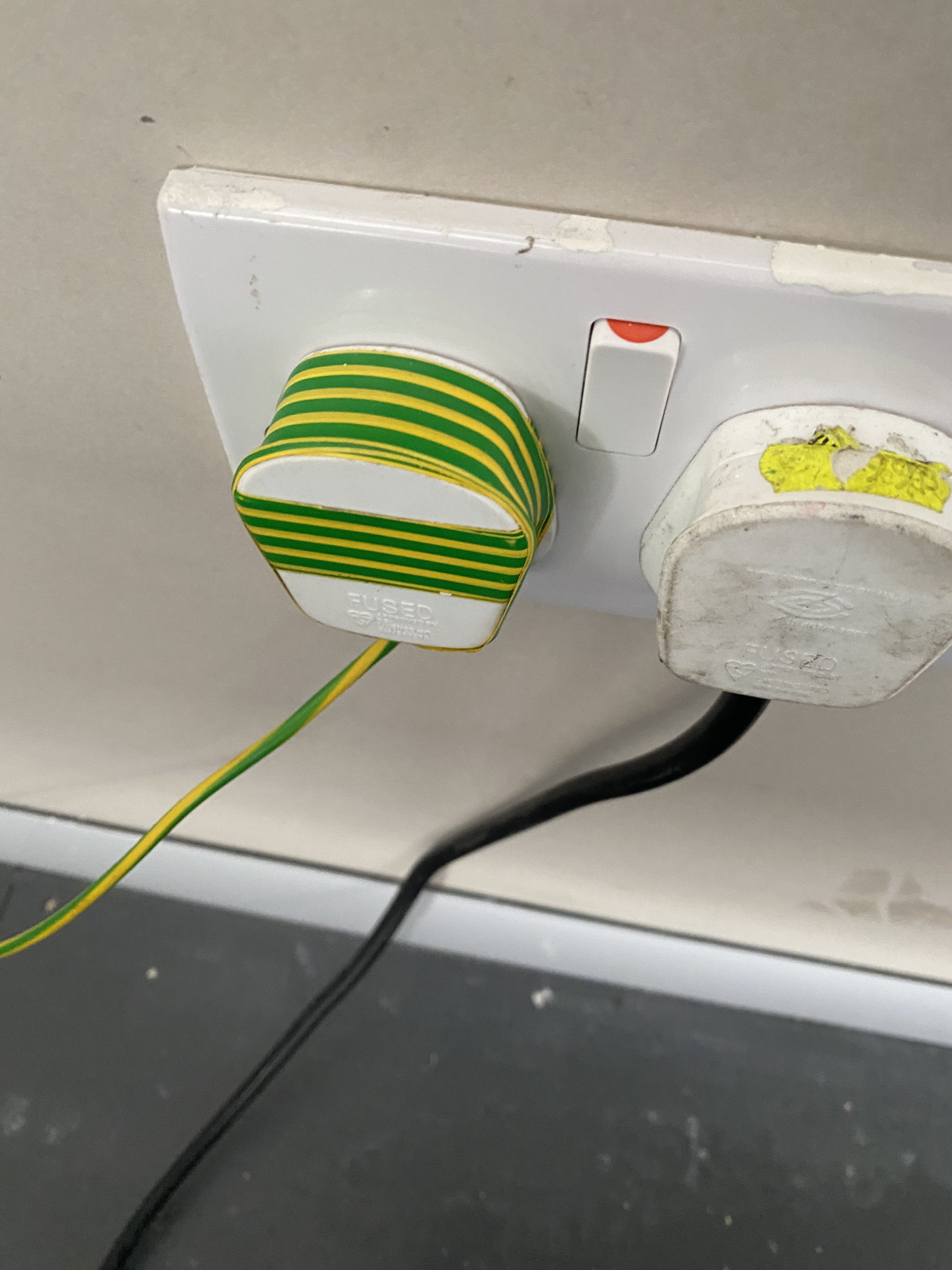

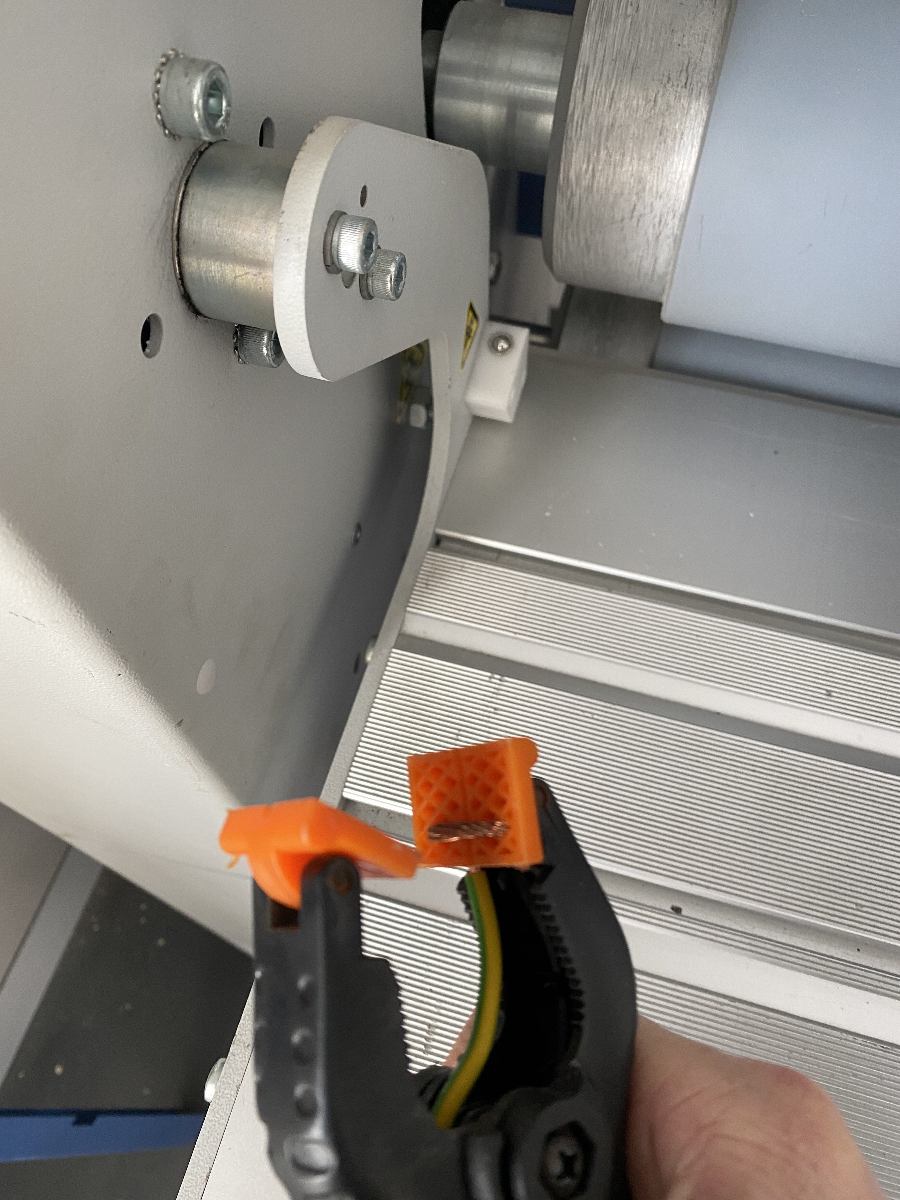

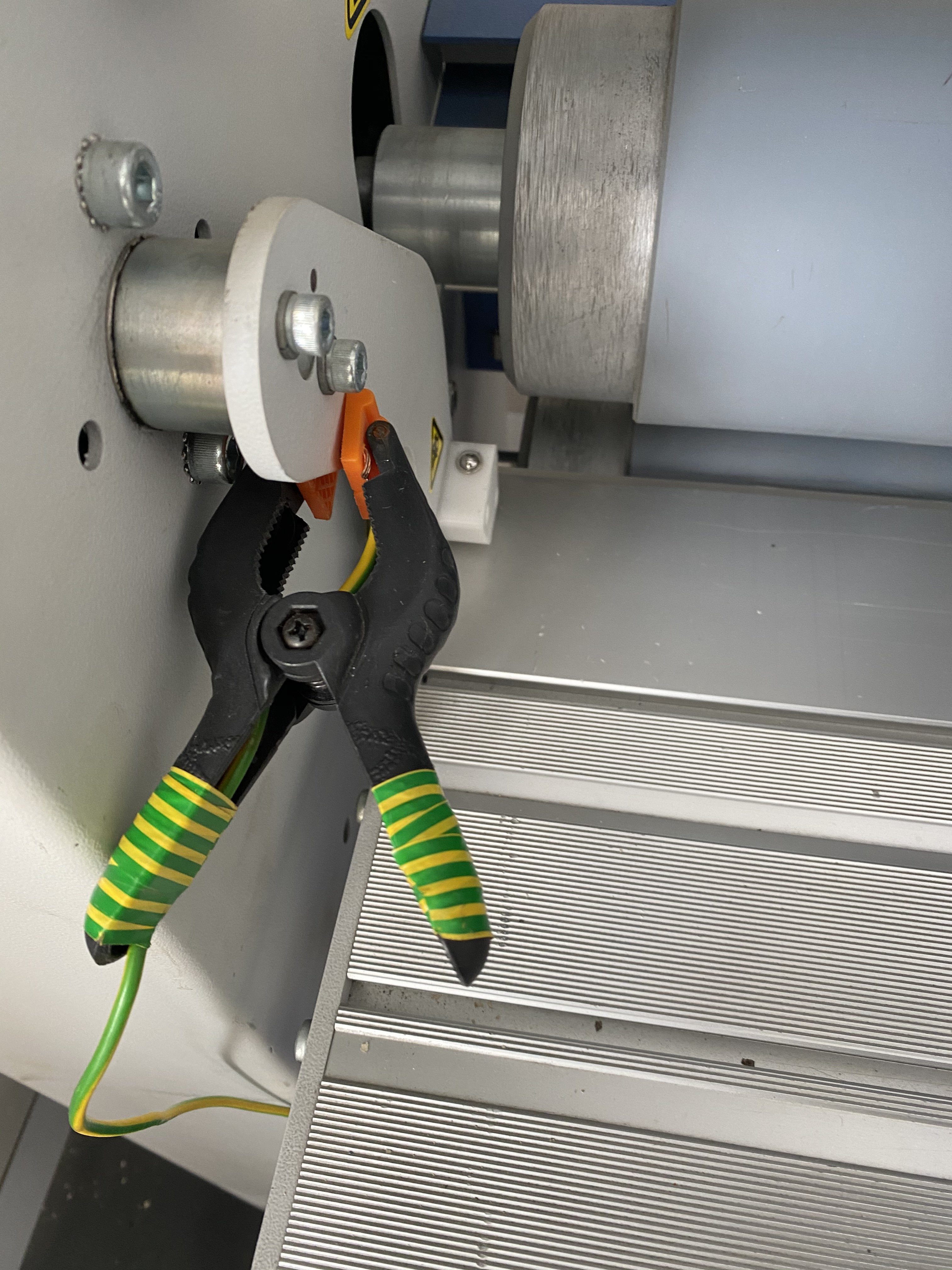

thats my version for the laminator, not sure if it works well, I still get shocks.
