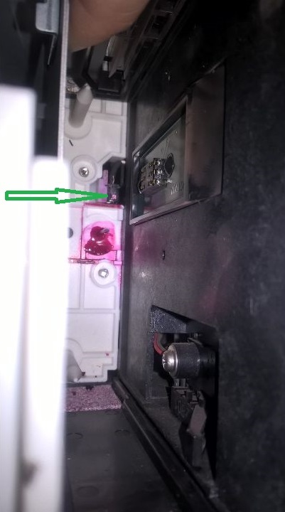

For check if cartridge detection sensor is working normally you can do:
- Remove the cartridge and open locker frame;
- Few times press to sensor's pin and check if printers's recognized it (pin on photo). Maybe pin is locked in some position and just need to release it.
