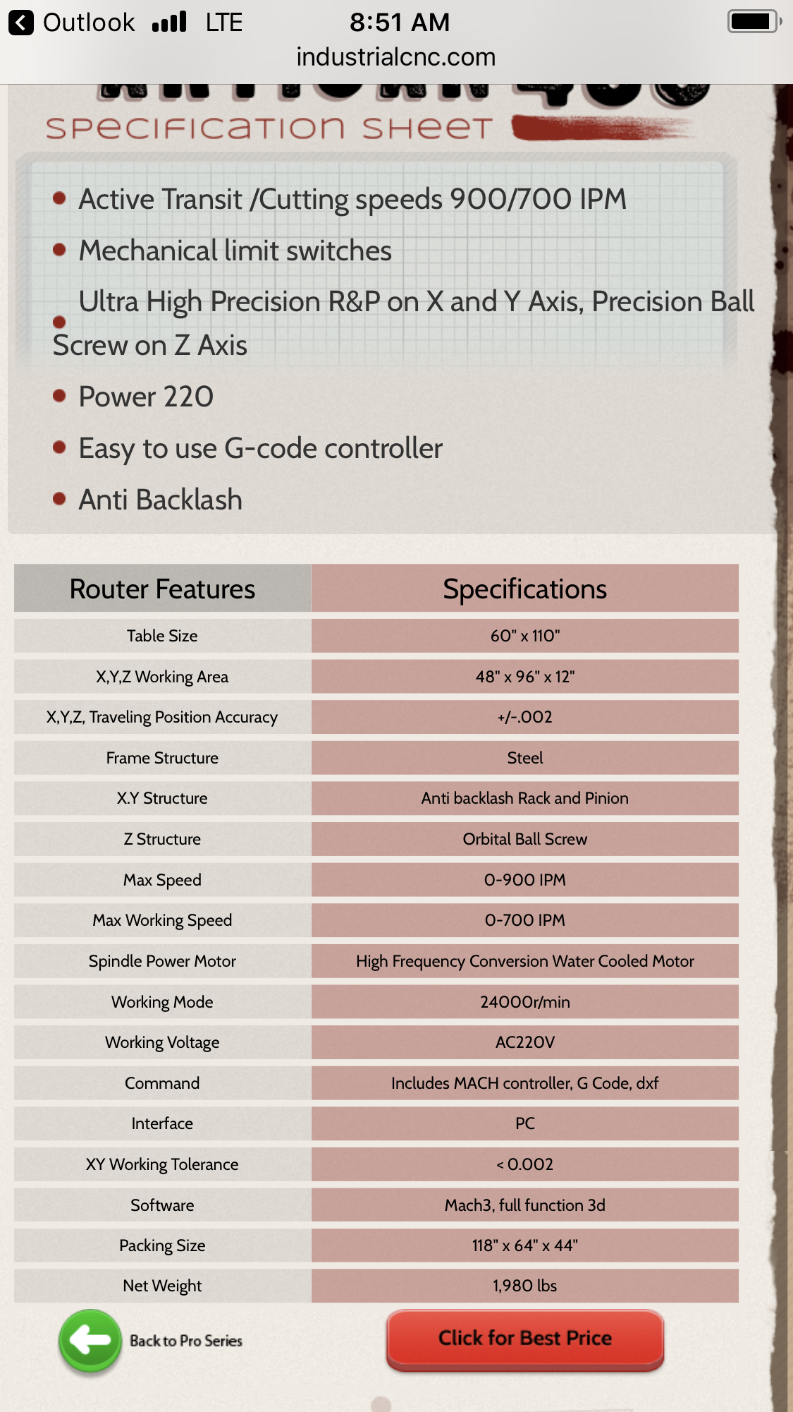

    Does anyone here own a Industrial CNC pro series? What do you think of it? Would you recommend it?
    Thanks

    It's fine for a hobbyist, but it's really not a production table.

    How much?

    15000$

    I know budget is always important when considering large equipment but like many have said you want to go big, even if you think a 4' x 8' is sufficient. You will come across an even larger project. If you are a small shop using it a few times a day that will be fine but there are other a long that price range like, Camaster & Shopbot, I would recommend Camaster. If you want something you can run 24hrs. then consider a AXYZ I would stay away from Multicam, we have several and nothing but problem with service and $$$. The features really come down to what you are doing and the usage you wouldn't need a tool changer if you are only going to do channel letters now if you have an extra couple of kkk's I'm sure you could find use for it in the future...
