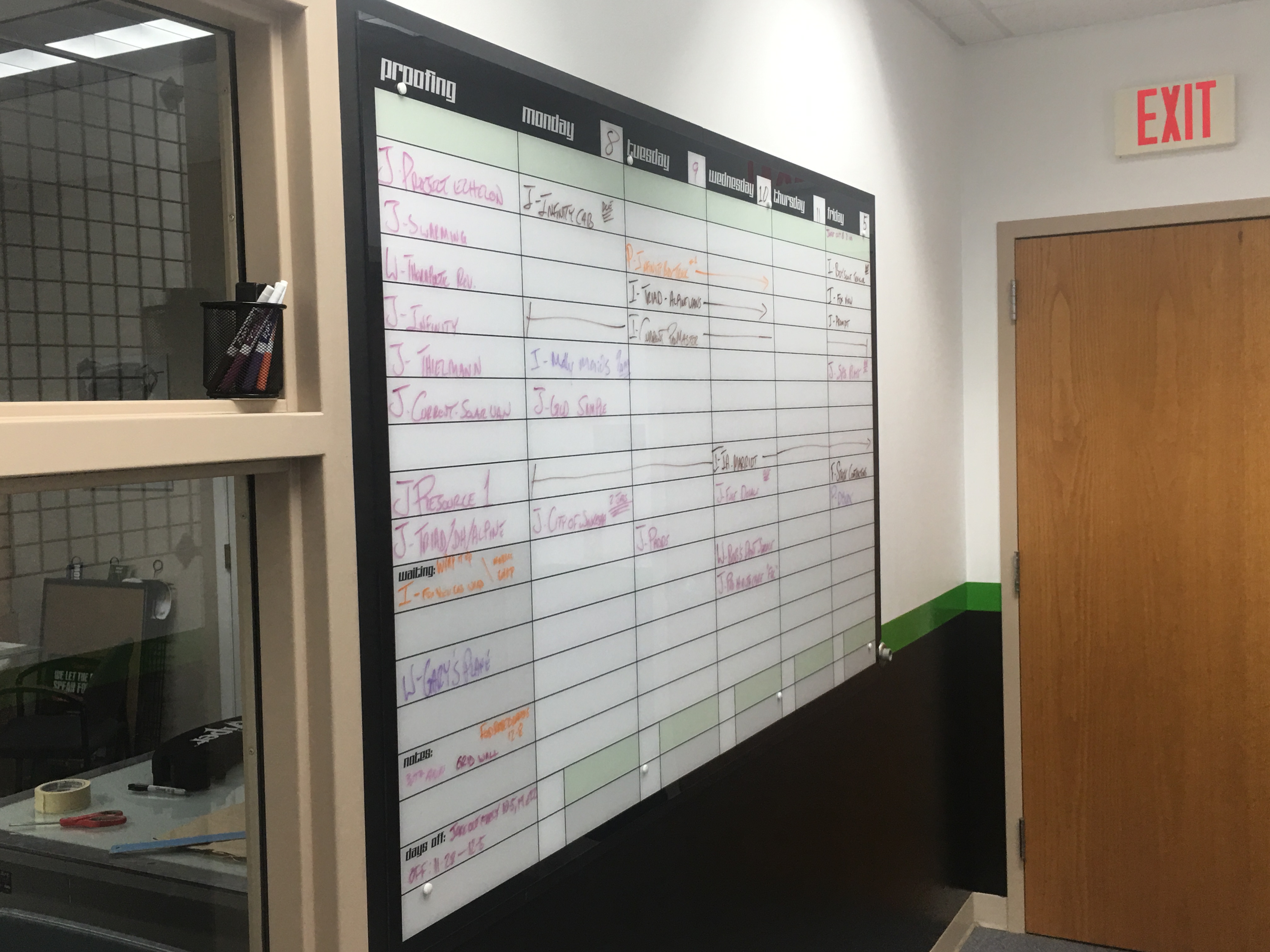

Acrylic works great...
We printed on the back with our flatbed and mounted to the wall
