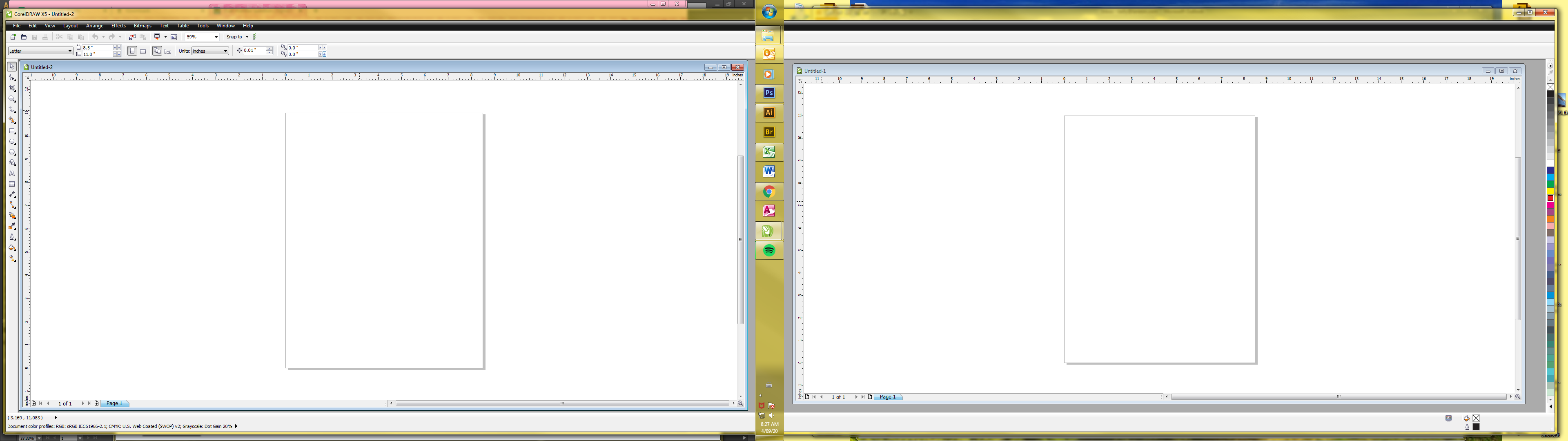

Is it possible to open 2 different files on a dual monitor setup? I need to copy/paste a bunch of info from one .CDR file to a new document I'm creating, I can't figure out how to open the existing file on one monitor, and the new file on my second monitor, is it possible?

Are your monitors connected to two different computers? Otherwise it shouldn't be any different than copy and pasting between two windows on the same monitor.
unclebun
You don't need to open two Corel Draw windows to copy and paste from one file to another. Just open both files in the same window. They come up on tabs, and you switch between them using the tabs. You did know Corel Draw has tabs, didn't you? They've been there for many years.
If you have dual monitors you can open two instances of Corel Draw. But why bother when you can copy paste in the same window?
Fred Weiss
Merchant Member
It's not a problem. You can launch Corel twice and drag one to your second monitor and open the same or different files on each instance.
CanuckSigns
I'm aware of how tabs work, but I'm trying to avoid having to jump between tabs a few hundred times.
Ideally I would have document 1 open on monitor 1, and document 2 on monitor 2 and be able to select an object in document 1, copy, then paste it into document 2 without having to minimise anything or switch tabs. Possible?

Isn’t it just as simple as, say, illustrator?
say I had two files open, I can switch between them from the file names up top (what you’ll be doing now). But if you drag and drop that file name instead of clicking it, it’ll open it In a new window. Then just drag that window to the other screen then maximise.

Yes, you can do that. Not only that, you can drag and drop the item across the windows too.
JimmyG
Yes you can, its easier for me...open 1 instance, move it to the 2nd monitor, then double click desktop icon to open 2nd instance for first monitor. I also use drag and drop and do it to take parts from old x7 files.

I have dual monitors and use CoreDraw. You can open Corel Draw one time of right side monitor then open up CoreDraw again on the left side monitor and Copy and paste back and forth

You Rip the Tabs away from the main toolbar and drag it to the other monitor.
JimmyG
That rip method works but you don't have any tools to work with on the tab that is ripped to another monitor. For that reason I prefer to open to 2 instances for 2 tabs.

In regards to launching multiple instances of CorelDRAW to drag elements from one document to another, that is definitely not necessary with later versions of CorelDRAW. A single instance of CorelDRAW can be opened on one monitor. Multiple documents can be dragged outside of the program window onto a second monitor (or additional monitors). It's usually easier to go to the Window menu and choose "Cascade" before dragging any open documents to other monitors (it's glitchy with a tabbed view setup). Tool bars and palettes (such as Object Manager) can be dragged outside of the CorelDRAW program window onto other monitors as well.
Older versions of CorelDRAW would not allow any open document windows or user interface elements to be dragged outside of the main program window. I can't remember which version changed that behavior. It was an overdue update; most of Adobe's applications would allow all sorts of stuff to be dragged outside the program window and onto other monitors many years prior to that.
Hi Bobby,
If you are using CorelDraw 2020, you don't need to open 2 instances of corel.
Just open the 2 files, then drag the one tab to the other screen and maximize it.
Then you can work seamlessly between the 2 documents.
