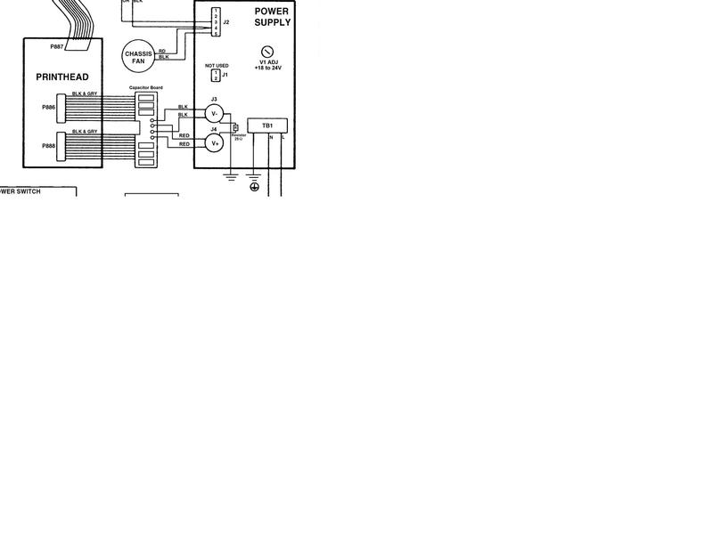

I think the power for the head comes from P886 and P888 on this diagram? the series of Black and gray wires each have their own tiny solder joint.
Sellers, I would check the connections at power supply, to capacitor board? ( I will check my own also).

Aaah and a very important note, the "earth" connection is vital for any electronic equipment, a lot of fails about of "bad earth connection" on the electronics devices, check it.
This is an Edge 2. I was wondering about swapping a head in like you say to test. Hielorojo, I searched eBay but couldn't find the $100 head. Maybe I wasn't using the right search terms to make it show up, I'll do some more searching. I called the plotter doctor earlier and talked to him about the situation. He more or less confirmed what we are thinking, it is almost impossible that the head is bad. He told me to take apart and re check all connections again and blow it out, and if that doesn't work he feels like it's a problem on one of the boards or in the power supply.
