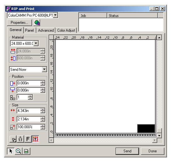

    I'm not printing to an Edge but I do use Flexi to run a thermal resin printer. I have had this happen in Production Manager a few times, somehow on it's own it changes the default setting of "Send Now" to "Hold in List", check to see if this has happened.
    You can also check Production Manager's preferences "Send After Output" default setting should be Delete not Hold or Archive. If you Hold or Archive selected this is where those old random job info could be coming from.

    It is set to delete the jobs after they print, but where to I go to find the send now or hold in list? I know I've seen it before but I can't find it now...

    Ok disregard that last question, I found it. It is set to send now. I am also thinking it is a software issue. I am using an aftermarket USB to parallel cable, but it has worked fine for hundreds of jobs. Maybe I'll just go ahead and buy the Gerber cable and see what happens, worst case I'll have a new $100 cable.

    When Production Manager opens to the General Tab/Screen it is right between the material settings and position settings. At least that's where it is on my old 6.5 version.
