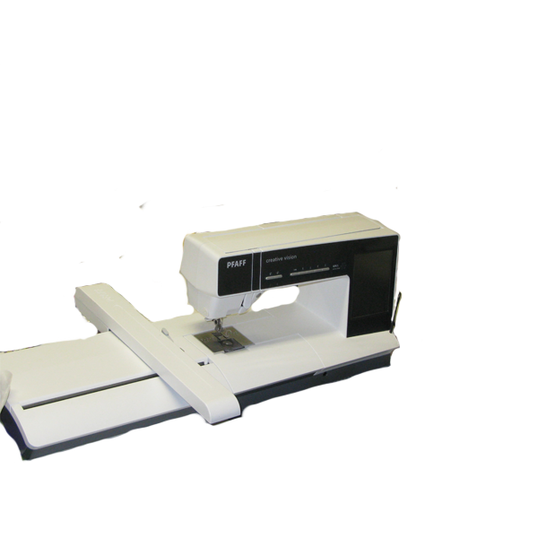

Actually I was thinking that maybe your mom might want to focus more on applique designs. Since it's not full embroidery, the issue of just having one needle won't be as bad and applique does usually command a higher price as well.
Having one needle is going to be her biggest issue. If she does corporate work, it'll be far better for her to stick with as few colors as possible or very short runs. I would say stick within 5-10 at most with a single needle machine. Her best bet is going to be the one or two garment runs. Those may not be so bad if they have a lot of color.
Attached is what we use that's like your mom's. It's a single needle sewing/embroidery machine. It's sews/embroiders great, but it's the fact of only having one needle that gets you.
Try to have her stick with the one/two runs and the applique work. More then likely those will be the best return for money and still retain the fun factor.

Yea that's more of a monogramming machine... not a business class embroidery machine. I 2nd what WWD said above.
SightLine
Thirded..... single needle would really really really be unpleasant for a multi-color design if you were trying to crank a dozen shirts through. I knew it wourl either be a Brother or Babylock. For those that do not know, the majority (if not all) Babylock machines are just OEM rebranded Brother machines. Also as Evan mentioned, with the screens they have, are some of the easiest to use as well. Still a good bit of a learning curve though for figuring out what sort of backings to use for what fabrics, machine quirks, hooping, what threads work best (rayon looks nice and is what many will suggest but not nearly as durable or colorfast as polyester), artwork issues that might cause problems such as too many colors, some gradients, tiny elements/text. More to learn than you might think...
