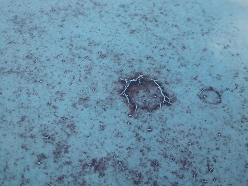

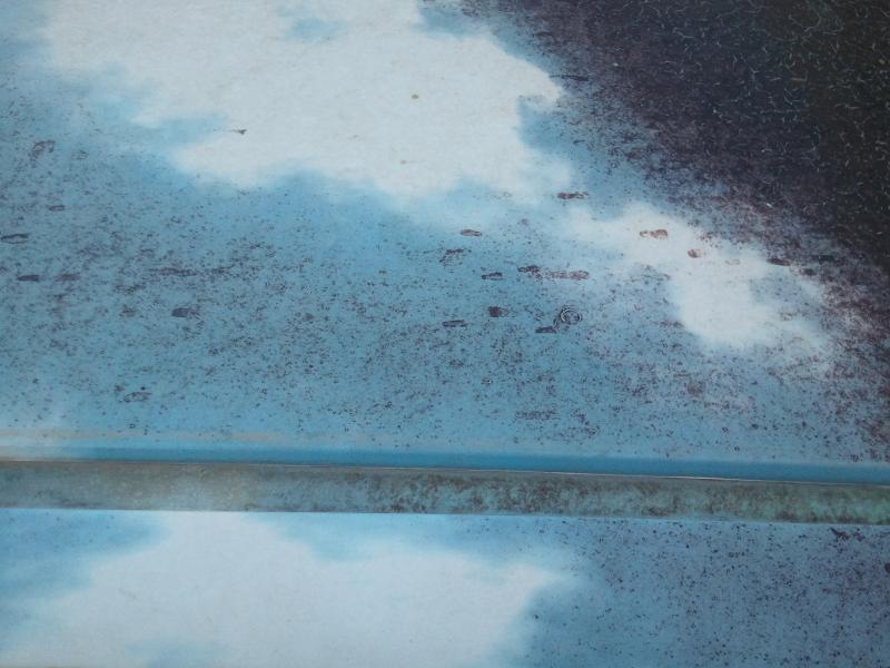

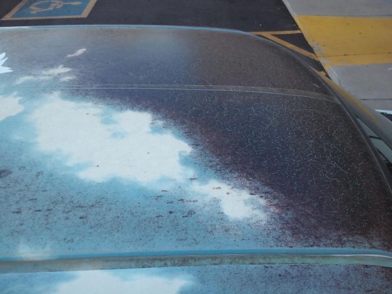

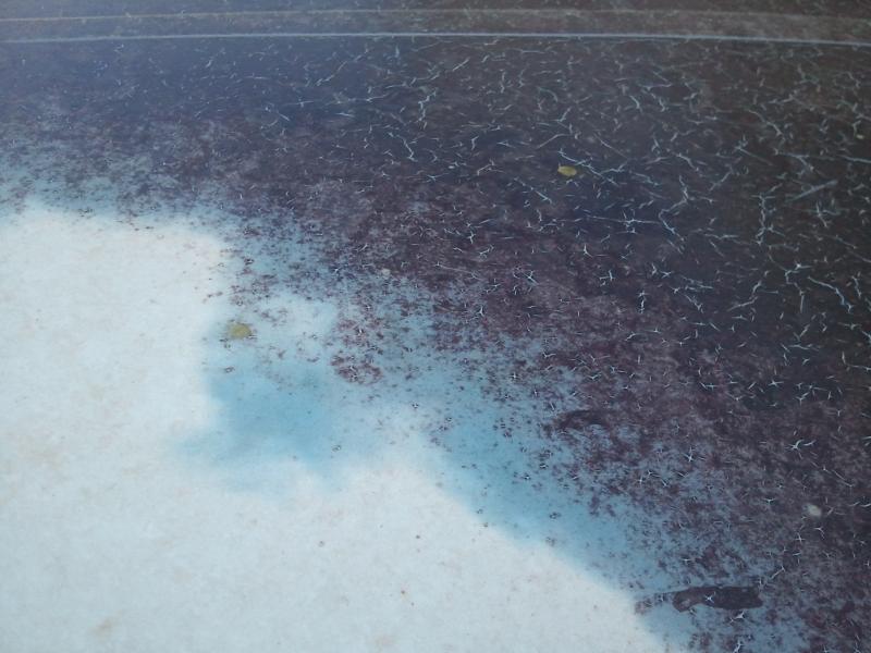

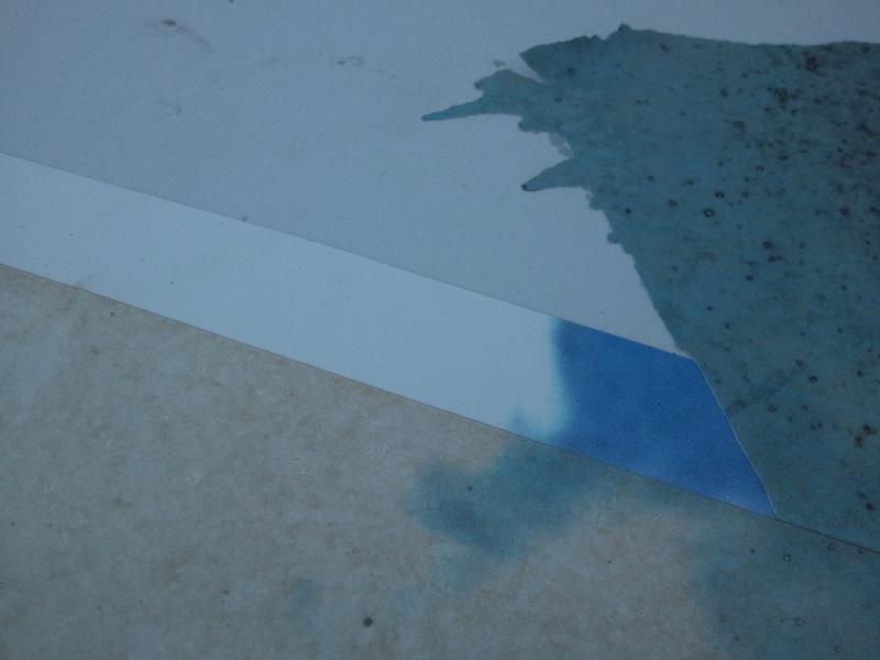

Is this just sun damage or is something else going on? Arlon 6000XRP with 3220 gloss lam. It was installed about May 2010. The design was just a blue sky with clouds. You can sort of see what the original colors were where I removed it over the seam. We're not warrantying it, as it's over a year, but I'm just trying to figure out what happened. In some of the pics you can see what looks like splash marks and one where it looks like a droplet started the failure. Thoughts?

I wasn't at this shop when it was installed, but the installer said he cleaned the vehicle with denatured alcohol. I was leaning towards sun damage, but the rest of the wrap, including the hood, still looks fine.
Desert_Signs
Don't know. I might attribute it to something like that, but what about the nearly solid black area? That used to be blue and white.
JoshLoring
One: that media has a lot of problems. Two: Denatured alcohol can be used as a fuel similar to diesel. It is NOT recommended for prepping as it leaves a residue on the paint. Use isopropyl instead. Three: offgas for 24-36 hours before laminating. Four: Client neglect of washing and waxing.

i would want to say that the denatured alcohol wasn't the culprit, as I prep aluminum panels with it all the time and never an issue.
My guess? Hot, Dry, Arizona sunlight simply cooking it?
Talk to your supplier about the issue and they will most likely have a better answer for you as to why their product is failing. I'm sure you're not the first instance of such a thing in your area.

that looks like a digital print with lam that I just pulled off of a panface. It had darkened so much you could barely see the print. I wold contact the media manufacturer on that one!
You say the print on the hood was fine? It does look like heavy sun damage.
All of these are factors although the exact problem is undetectable.
+1 for all of Josh's comments.
Also, sometimes the manufacturer's of laminating films can have uneven dispersal of UV inhibitors throughout the film (equipment failure). Add to this the Arizona sun and you might see serious damage such as your wrap. This could explain why the hood is fine but not the roof. It may be worh sending samples back to Arlon for lab testing.
