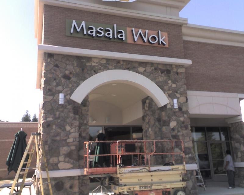

As mentioned before, I think that means they want it on a dimensional backer. This is one of several we did with a simple .080" aluminum rectangle pan background, 2" deep. We used remote transformers and wired it with the zero-clearance Neon Power-Pro secondary leads because the owner didnt want PK housings and a bunch of 2" holes in his new brick. The floppy banner was by others.
Neon Pro is the worst Secondary cable you can use and has the highest capacitance, even worse than the old jacketed black stuff by Paige. I would highly advise anyone not to use this stuff unless a applications really calls for this stuff, and I don't even know what that would be.

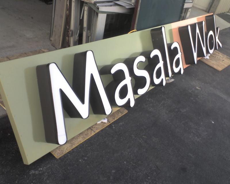

HERE is a photo of a sign we did that has a similar construction. The difference is that your channel letters will have clear faces and be flush mounted. Also your wire-way will be a custom shape.
John L
I hear you on the capacitance of the PP cables. These were fairly short runs but behind the brick where the LL didnt want holes drilled because he has no faith in tenants remaining any period of time, is structural steel in the most awkward configuration we have ever seen, and a finished interior maintenance room where the trans box had to be wall mounted. If we could have been allowed to make a hole someplace during the survey we would have done things differently.
Looks like channel letters mounted on a pan to me....... and if you do channel letters on a pan , you will not have to put a UL sticker on every letter as u would if you had the channel letters direct mounted.
