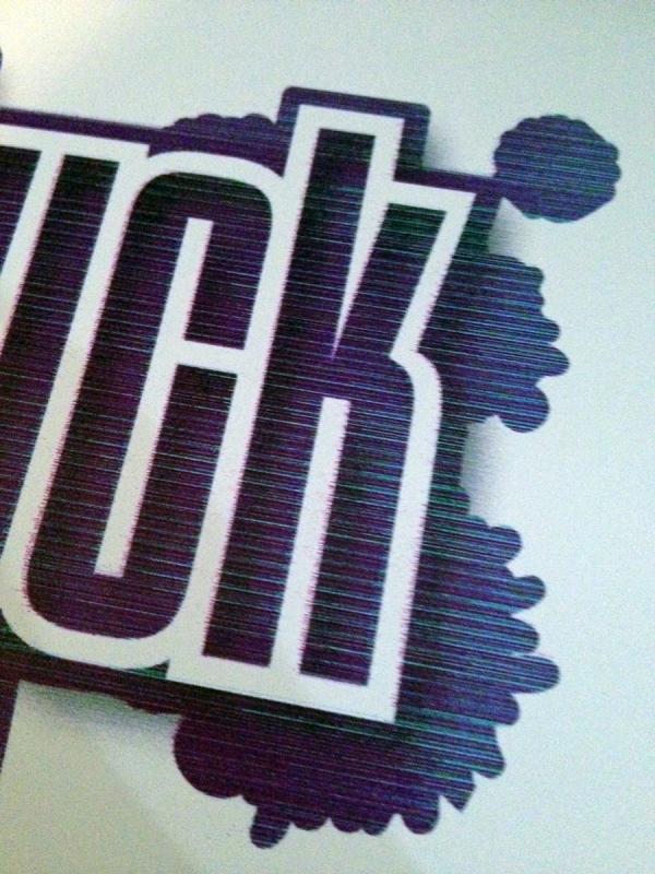

So my falcon started dropping / not fully printing its magenta cartridge. New 3/4 oem ink, damper is newer also.
Ignore the banding *threw some scrap material in to test print the problem until I figure out what is going on exactly... and any other printing problems other than the magenta issue..

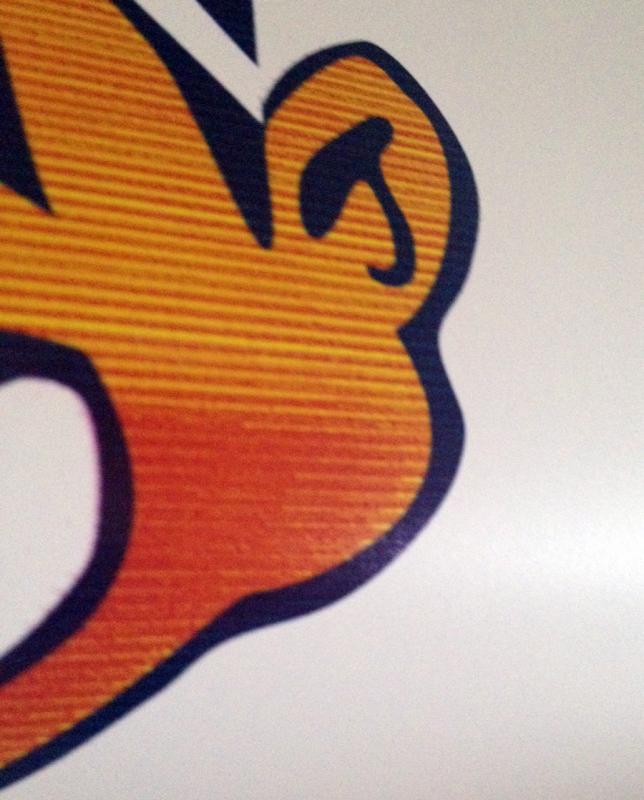

Here is another.
SO, the damper starts full obviously, but then empties? causing the loss of magenta?
