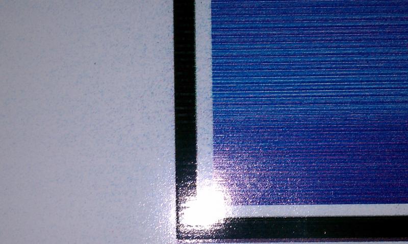

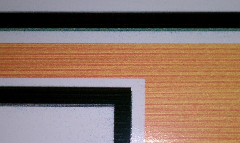

heres some pictures of what its doing now. right before the capping station went out it was printing perfect. so if some one can give me some advice on how to fix it, thank

Robert M
Damper
If only the cyan is not pulling through it may be time to change the cyan damper.
Are you in Douglas wy? I have those dampers in Denver if you need them
elsignshop
no im in douglas, Ga, i changed the damper and now it prints like in the pictures. cyan comes out now but it prints really ugly like if the color head is going out. do you have color heads Robert M
printing238
4 things that can cause a problem like that, pump, docking station, head stuffed and damper.
your pump is working fine and you have put a new docking station in so change the damper.
If that dosn't fix it swap the cyan line with yellow line on head and print something yellow, if it prints cyan fine its your head.

im using regular mutoh eco solvent inks. i change all 3 color dampers. im going to change the lines of the cyan to the yellow and the cyan to yellow and see what happens.
