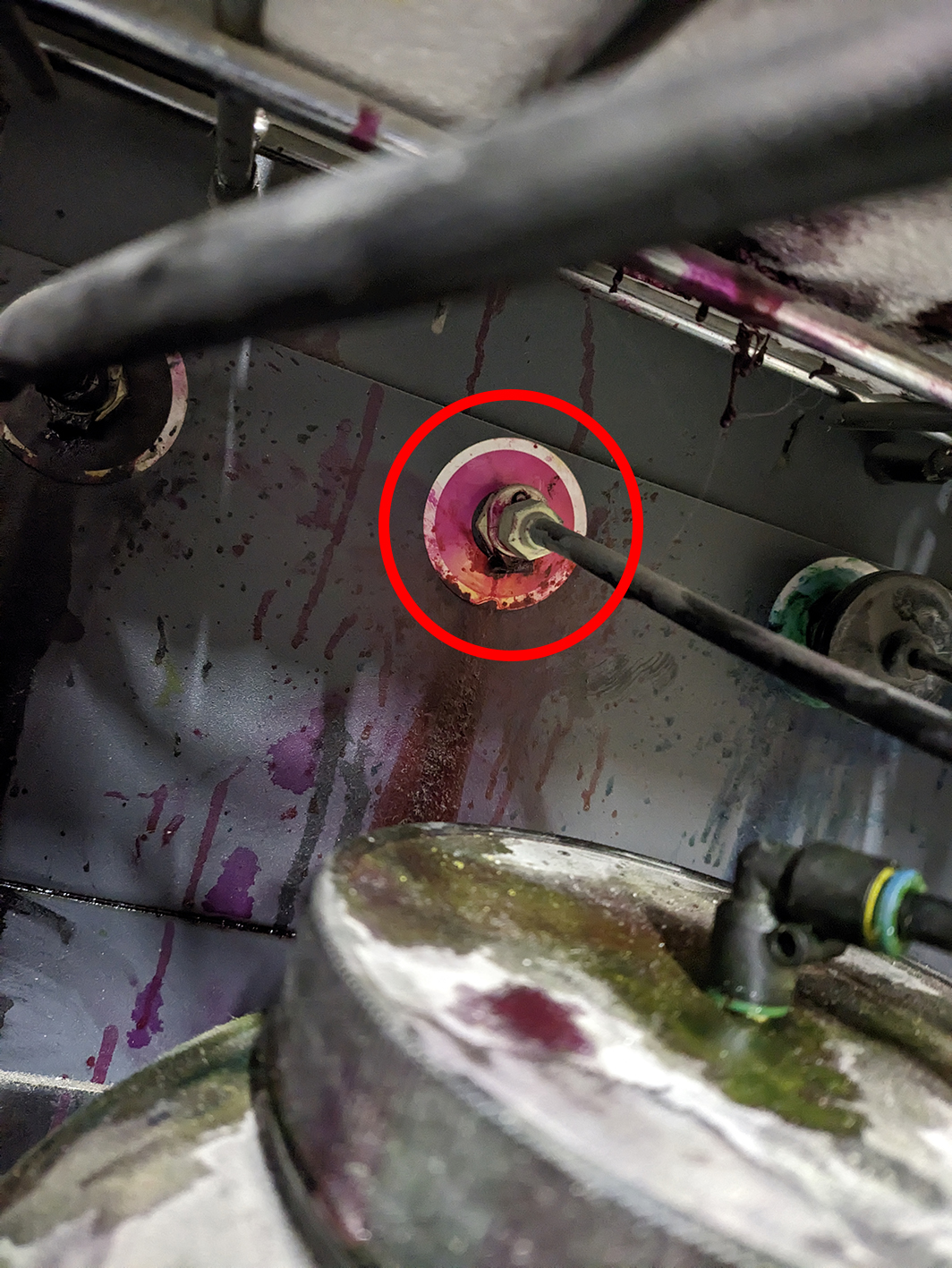

the orange at the reservoir and properly reconnecting the upper reservoir to the lower is 90% of ink drop to issues. If the tech overtightened the screws its damaged. If they are not aligned perfectly, damaged.

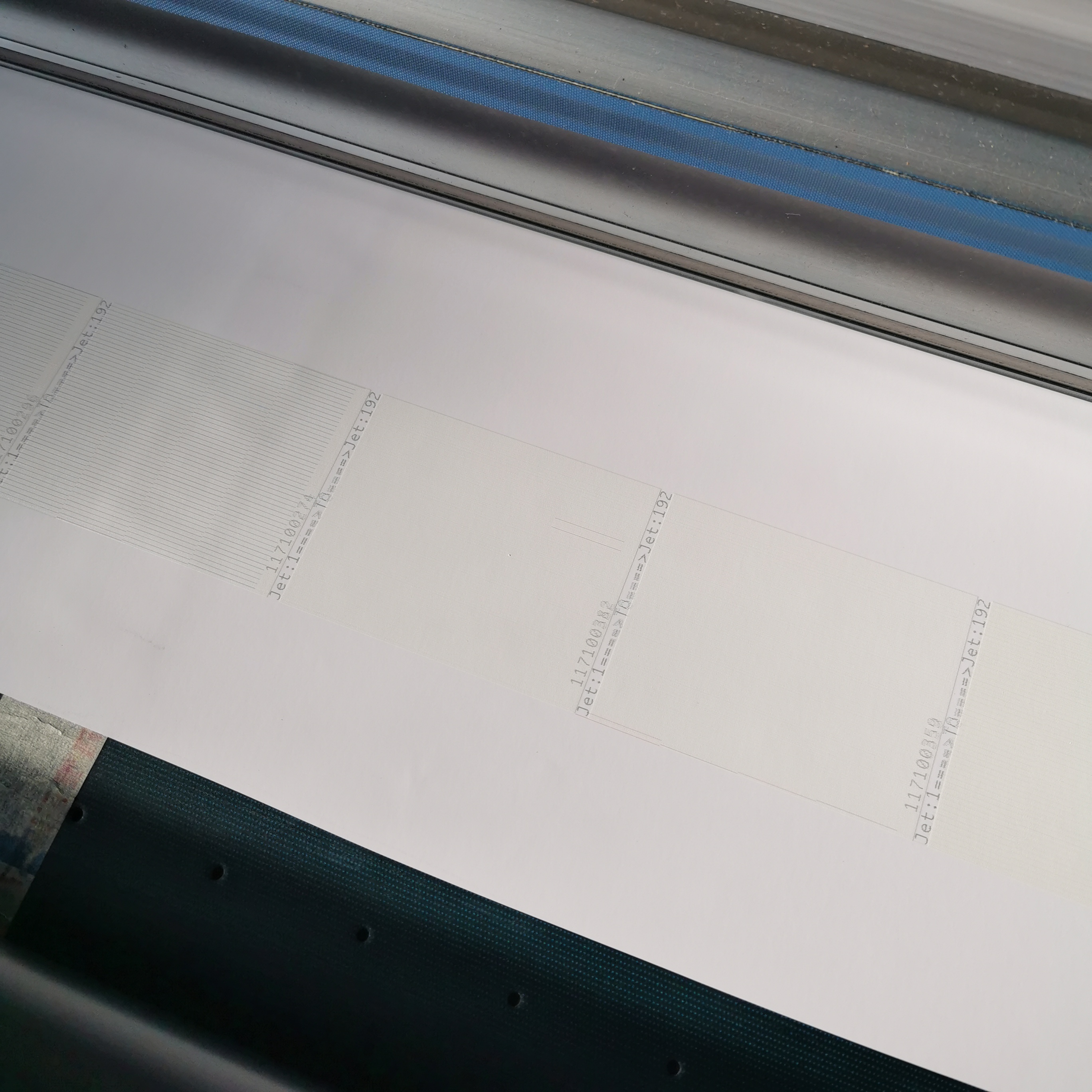

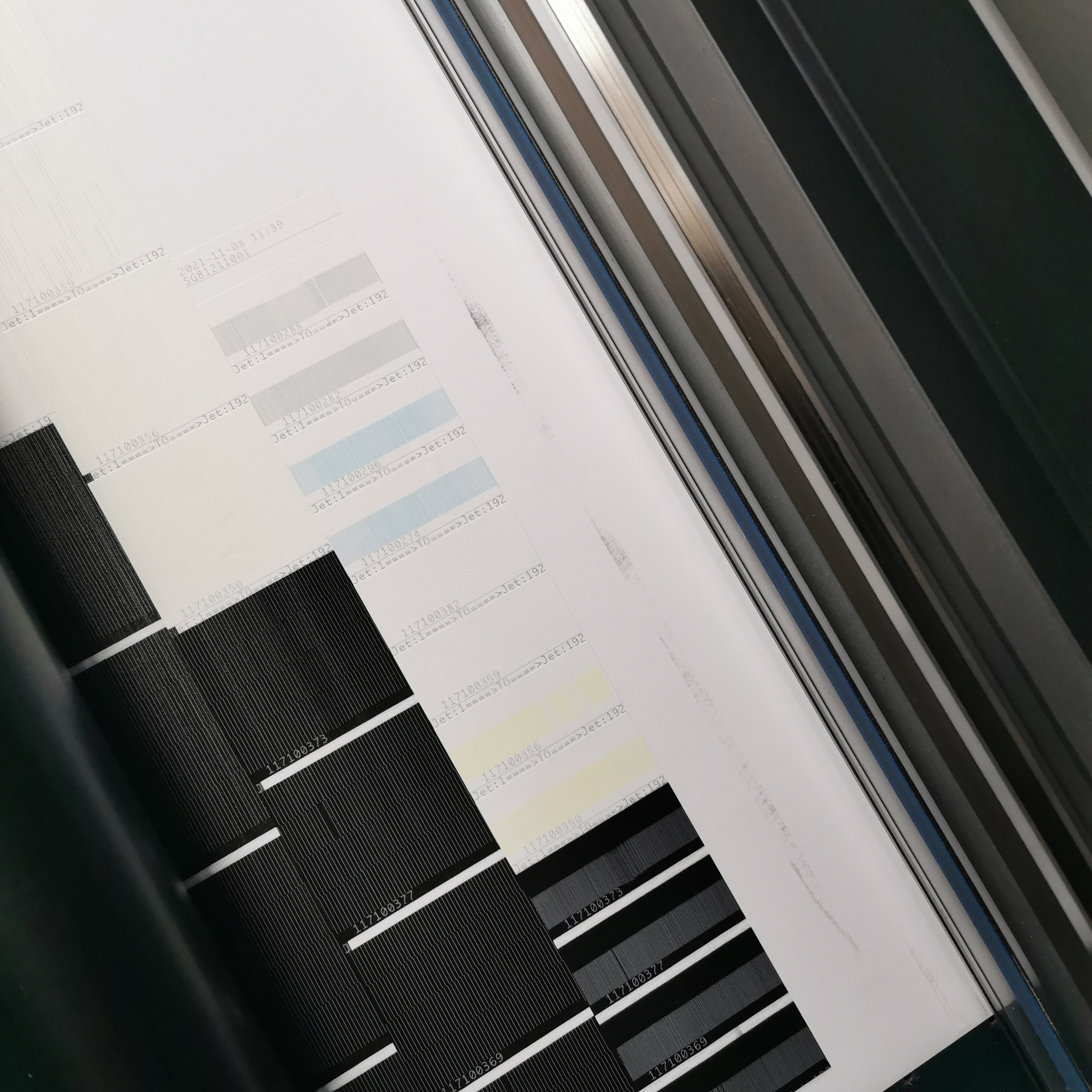

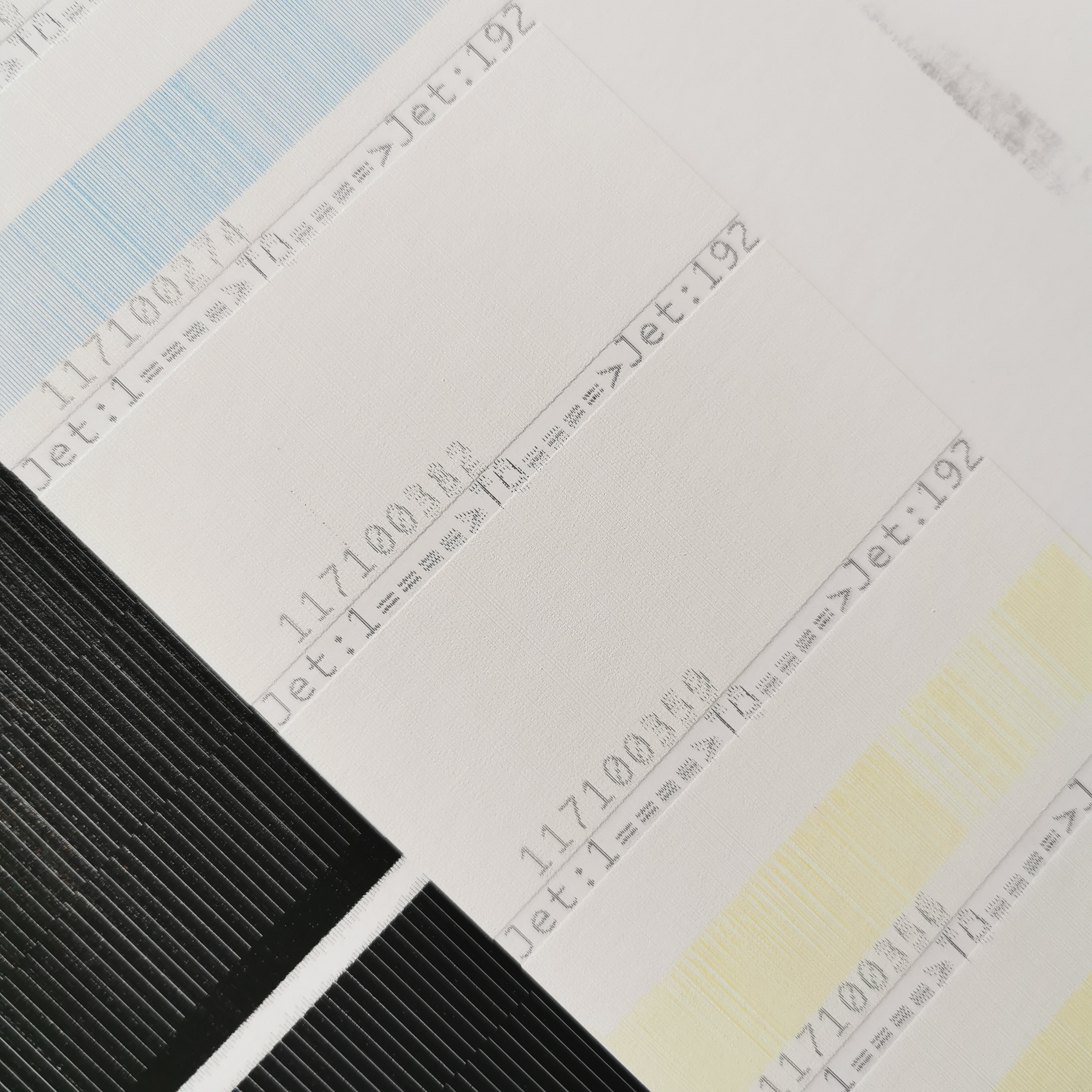

Hello, i'm having a problem with magenta, anyone with the same problem? I'm freaking out with this because i had an big problem with white a year ago, then with yellow, two weeks ago with black and now this.
I guess i will check other brands when i have the chance because im tired of HP. I have the fb550 by the way.
