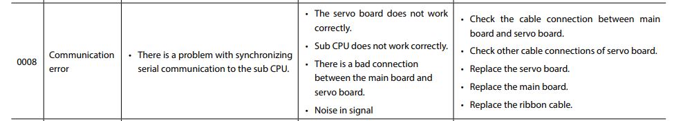

    I have an SP-300 and I just started getting a feed motor error 0008 message.
    Any idea what that is and how to fix the problem.

    From the Roland Web Site:
    This is a feed motor over current error where a light load is put on the motor movement over a long period of time. Turn the power off, clear any media jam that may have occurred and turn the printer back on. If the error continues, please contact your local Roland Service Center.
