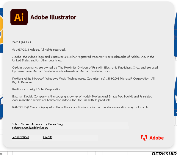

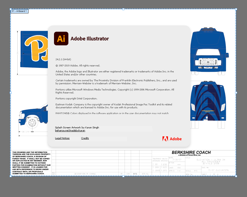

    I'm curious about the "larger canvas" aspect of your question. As far as I can determine, Illustrator still insists on the arbitrary 227" x 227" limits. I have longed for Adobe to "borrow" the scaling feature from CorelDraw that allows you to use "full-sized" dimensions while doing scale drawings- just for the sake of ease (because I admit I get math stupid at times).

    nah with illustrator 24.1 (think it’s that) they made the art board sizes HUGE. Like 57m square huge.

    Well, that's what I'm running, and it's still limited to the "canvas" size- 227" square. Did some checking, it appears to be 24.2 is where it's implemented.

    This drawing is a full size shuttle bus on a 640" by 470" art board. So nice I don't have worry about scaling in the RIP.
