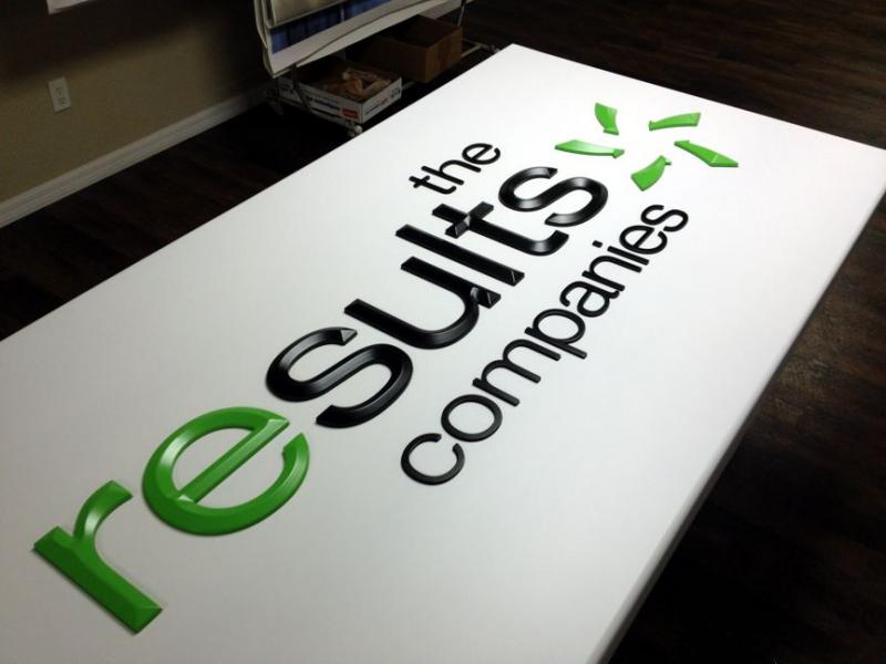

    And in the new paint booth. Only wish I had done this years ago.
    The Green is Lime Lollipop, almost perfect match for Kawasaki green. Mixed from a PMS color and hit the color 100% perfect on our very first custom color mix attempt! 3' x 6' PVC sign.

    Okay thanks for the clarification. I know what that is but I'm more of a spelling kind of guy and hadn't seen that acronym before.
    Matthews is single stage urethane but you can also clear coat if you like. I went with satin setup along with gloss clears for when I want to go that route. My Orlando branch Glantz was great in getting me everything I needed. I'd definitely follow up on that and raise some hell.

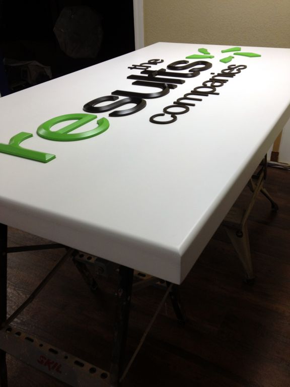

    The sign is 3'h. x 6'w. The face is 3/4" PVC with a 3" HDU return on the edges to make it look thick. We cut the prismatic letters from the same 3/4" PVC. The smaller letters were cut from 1/4". I did a .06 deep hog out to inlay the letters. This way my guys can't screw up the spacing trying to figure out where everything goes. No way to predict lifespan of paint due to several factors, but I do expect to get a minimum of seven year if the client doesn't lift a finger to keep it clean, they never do. Dirt and grime will make it look like crap if they can't be bothered to wash it. That's okay, I'll gladly repaint it when the time comes and charge them plenty for it.
    Oh and it's an exterior wall sign.
    Here's an edge view.
